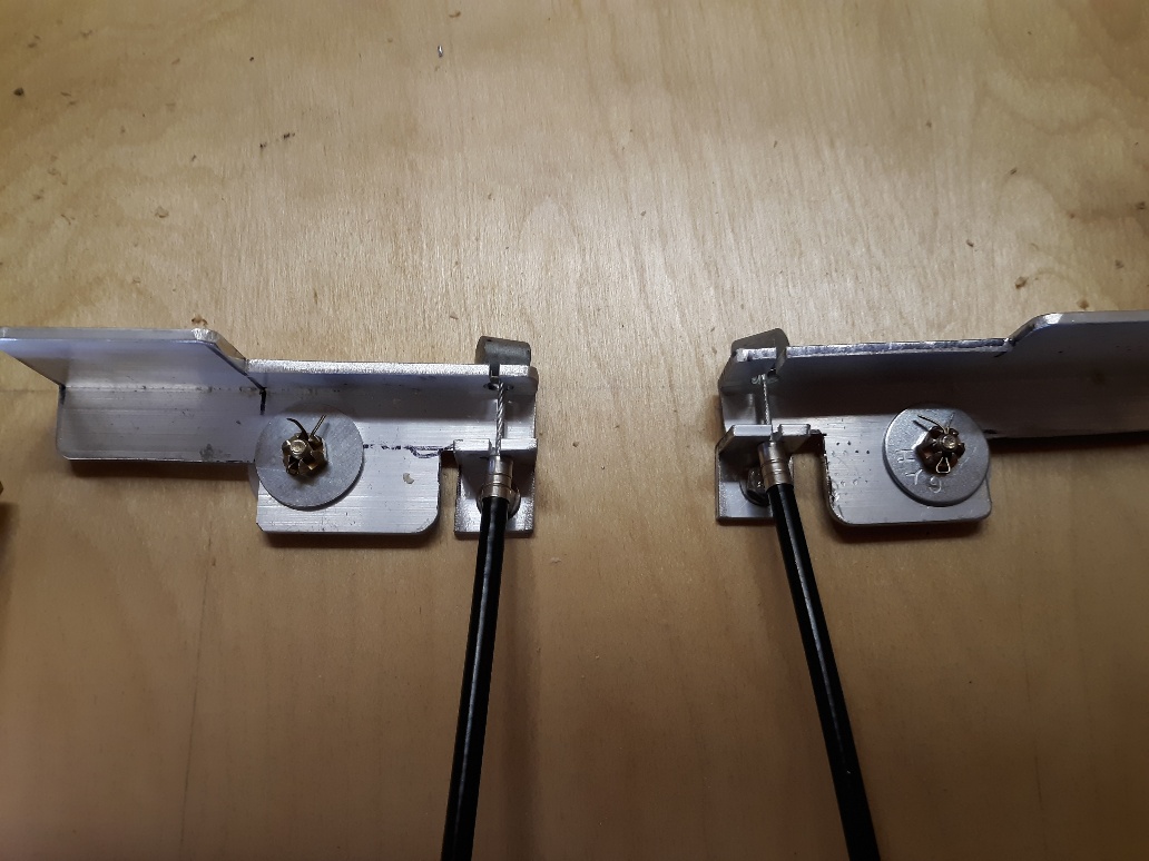

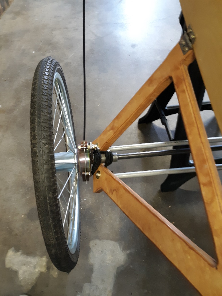

did some more tinkering with the brakes, Made little parts to hold the cable while the peddles were pressed. I hooked up the cables and gave the wheels a spin to test them and they seemed to work.

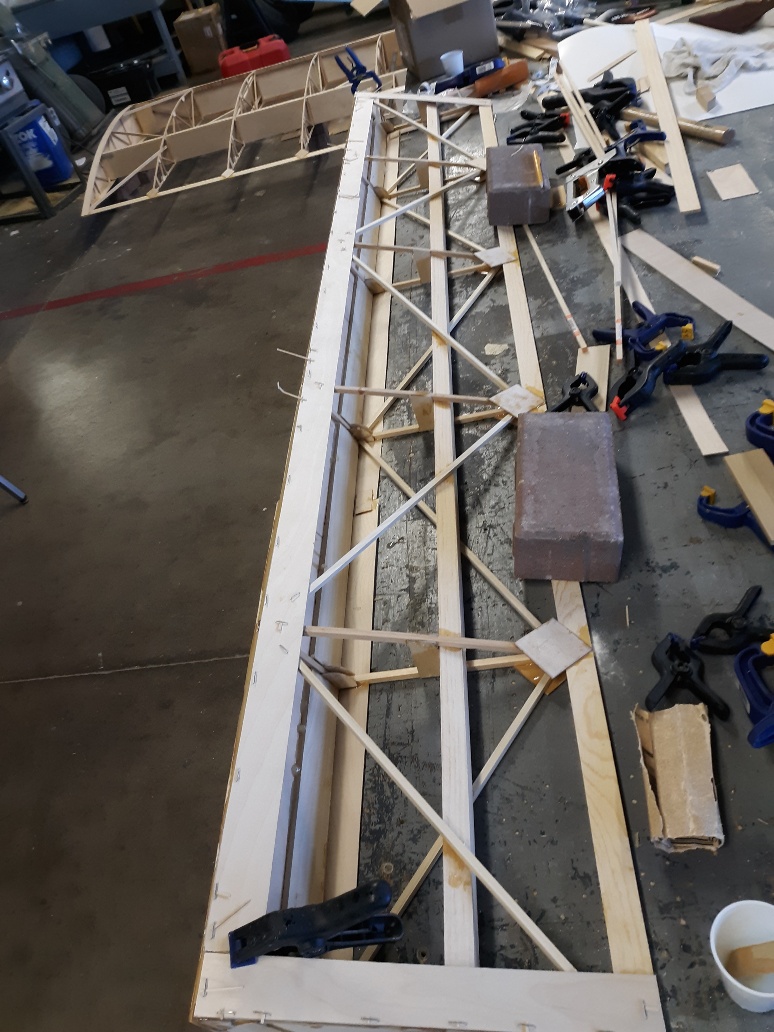

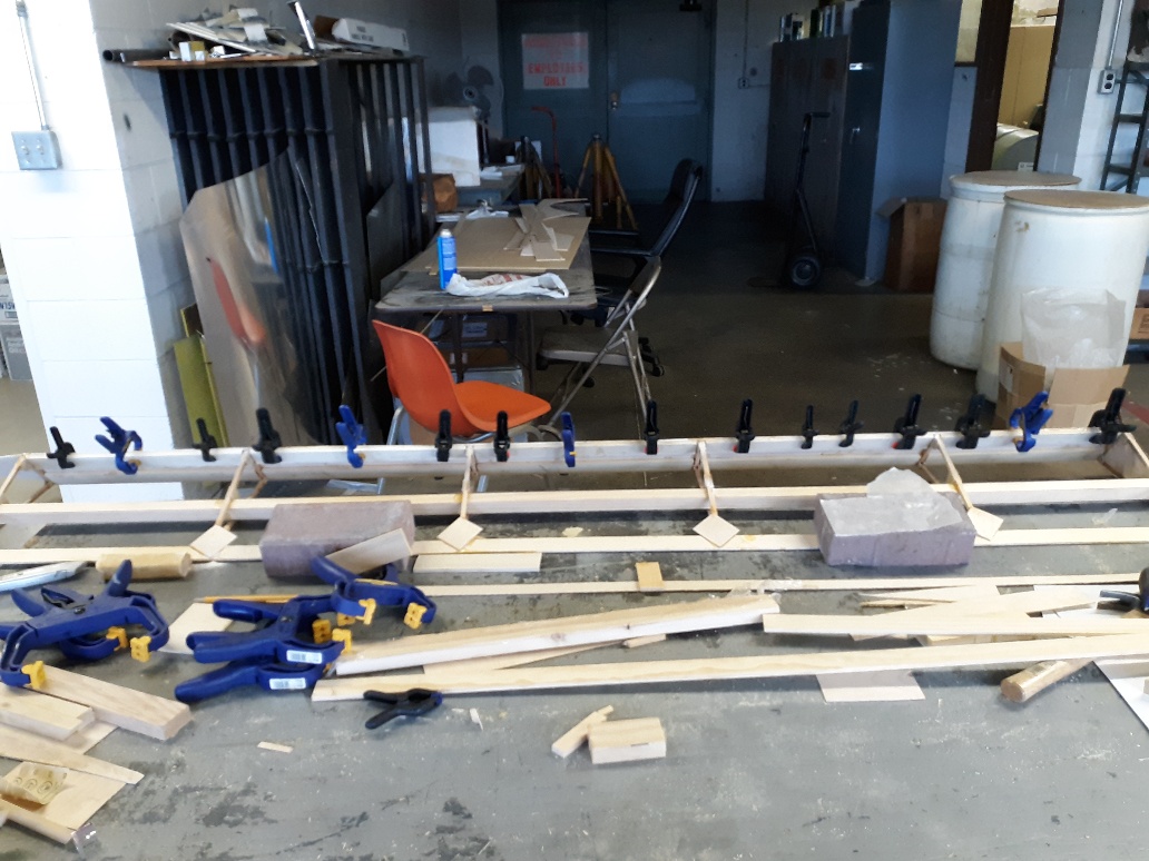

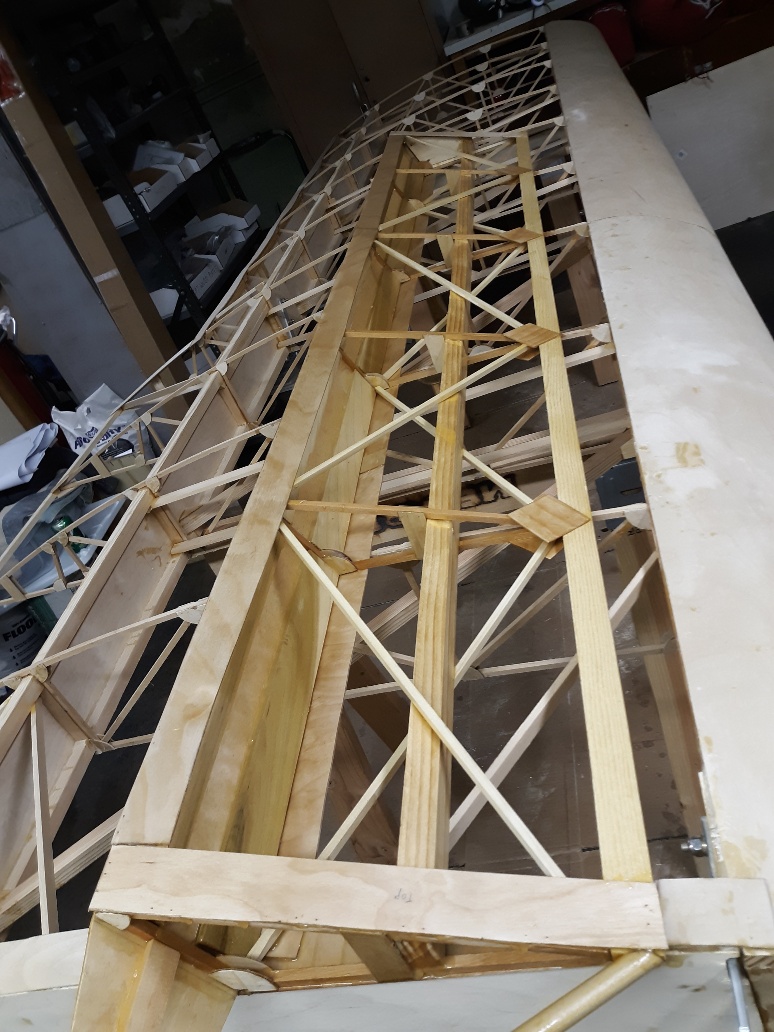

I cut and glued in the wood behind the plywood web of my ailerons.

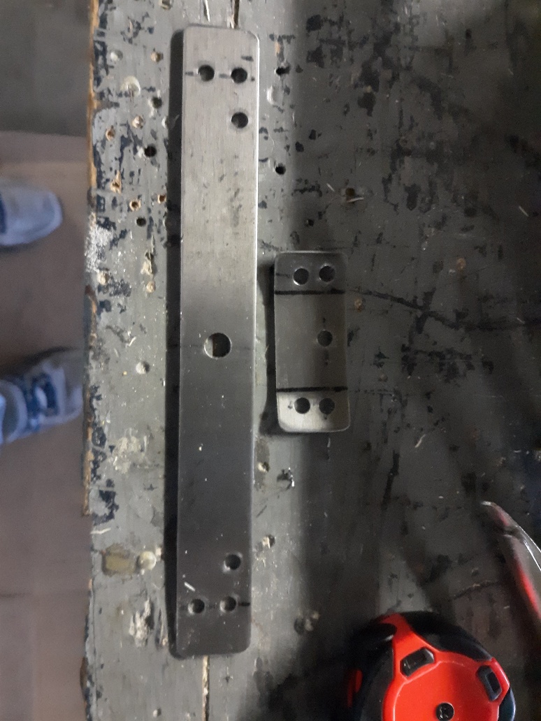

i snuck off and turned a strip of metal into a steering bar and a bracket for the wires to the horizontal stab.

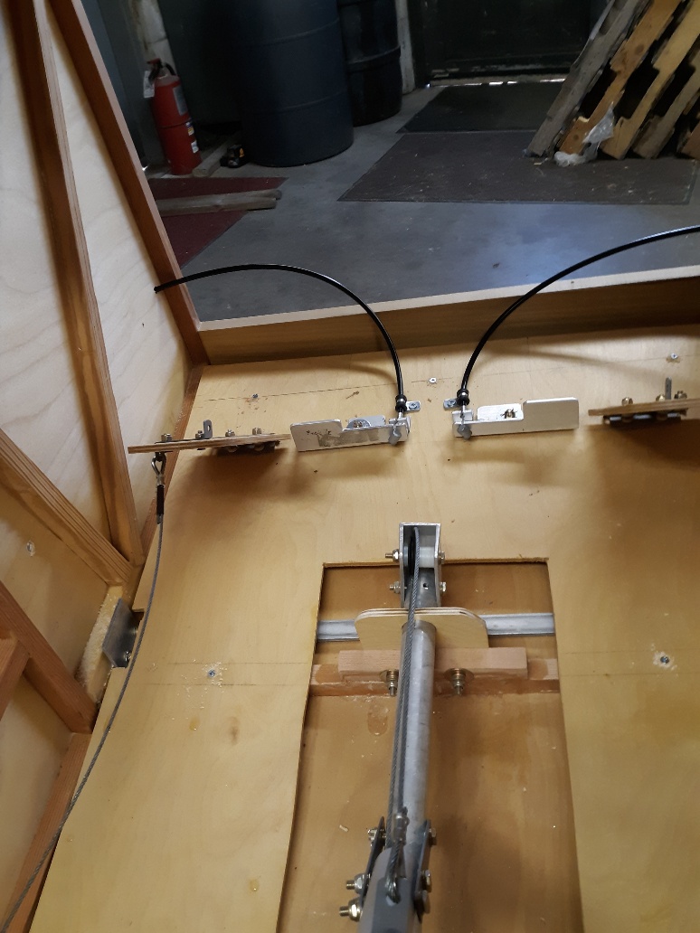

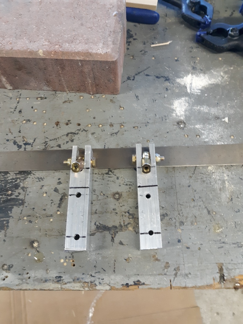

I worked some more on getting the wings varnished. I plan to use the stewart system and I have talked to them to confirm the varnish i am using will work with their stuff.
I also took a break from varnishing to make the parts for the pulleys to the aileron control wires to attach to.

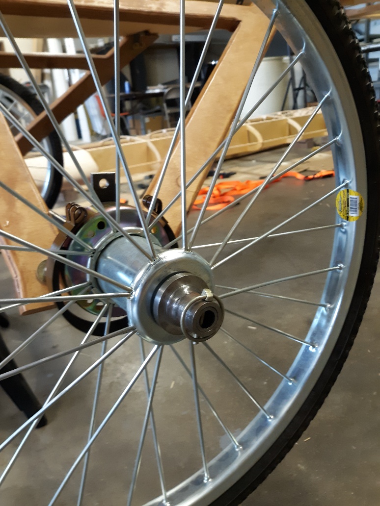

PostPosted: Thu Oct 10, 2019 5:33 am    Post subject: Re: Ragwing Ultra-Piet Reply with quote
I was looking at your Heel brake pedals, and I was curious. Are you going to attach a return spring to bring the pedal back to neutral? I plan on using heel brakes as well and was curious about how you planned to deal with that.
- The Matronics Pietenpol-List Email Forum -
http://www.matronics.com/Navigator?Pietenpol-List
Semper Fi,
Terry Hand
Athens, GA
cdlwingnut
Joined: 20 Feb 2017
Posts: 146
PostPosted: Thu Oct 10, 2019 3:29 pm    Post subject: Re: Ragwing Ultra-Piet Reply with quote
mine are band breaks so the tension of the band returns the peddle.

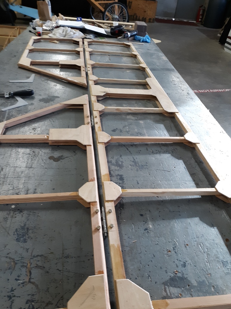

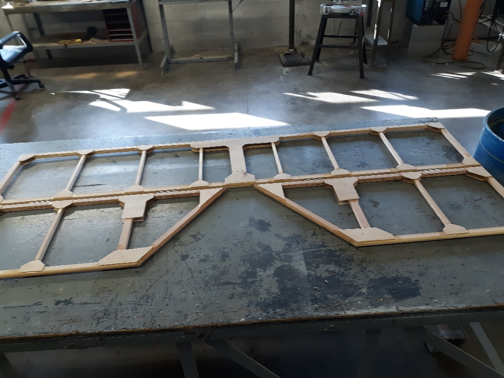

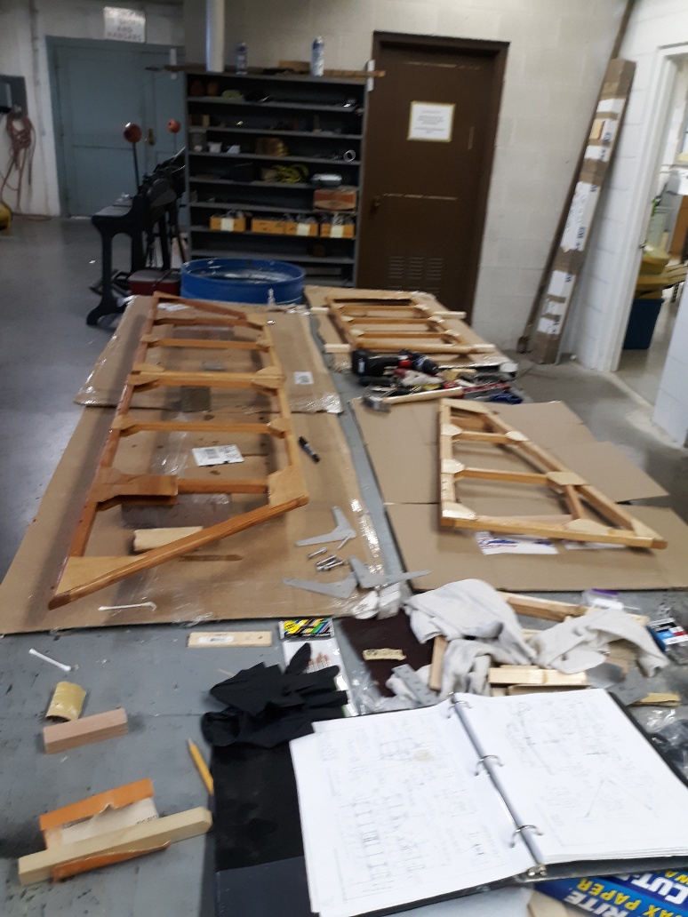

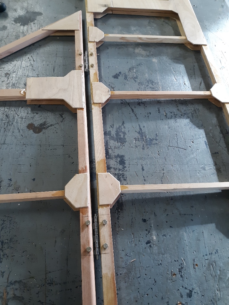

sorry for the lack of updates but haven't had any progress to report until today. I haven't had much free time lately. I did find some time to do a job I have been putting off out of fear of screwing up parts that took a lot of time to build. I cut the slots for the hinges on my horizontal stab and elevators.

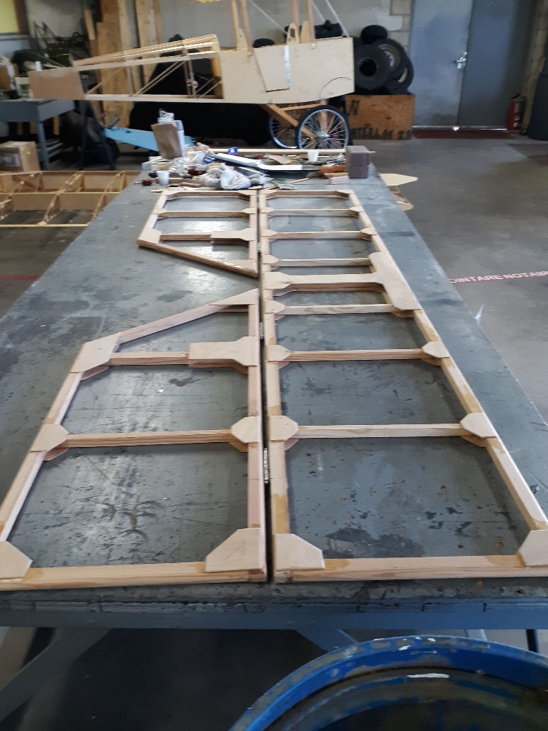

more work on the tail feathers installing the hinges and control horns. Also always lots of varnishing

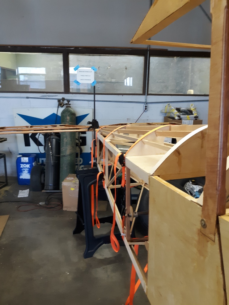

I attached the rudder cables to the rudder peddles. then fitted the front plywood and stringers. now i can adjust the front gas tank and start gluing.

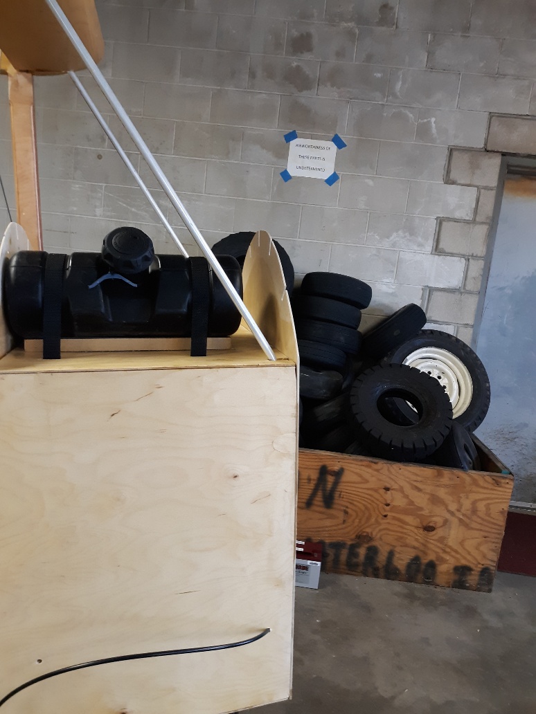

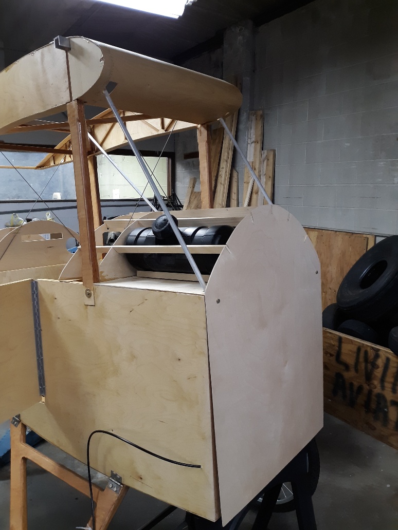

been pretty busy with work so haven't has a lot of time to slip off to the shop. but did get a little time today and got the nose sealed up and some final touches done to the aft turtle deck.

What is the firewall material that will go over the plywood? Stainless?
