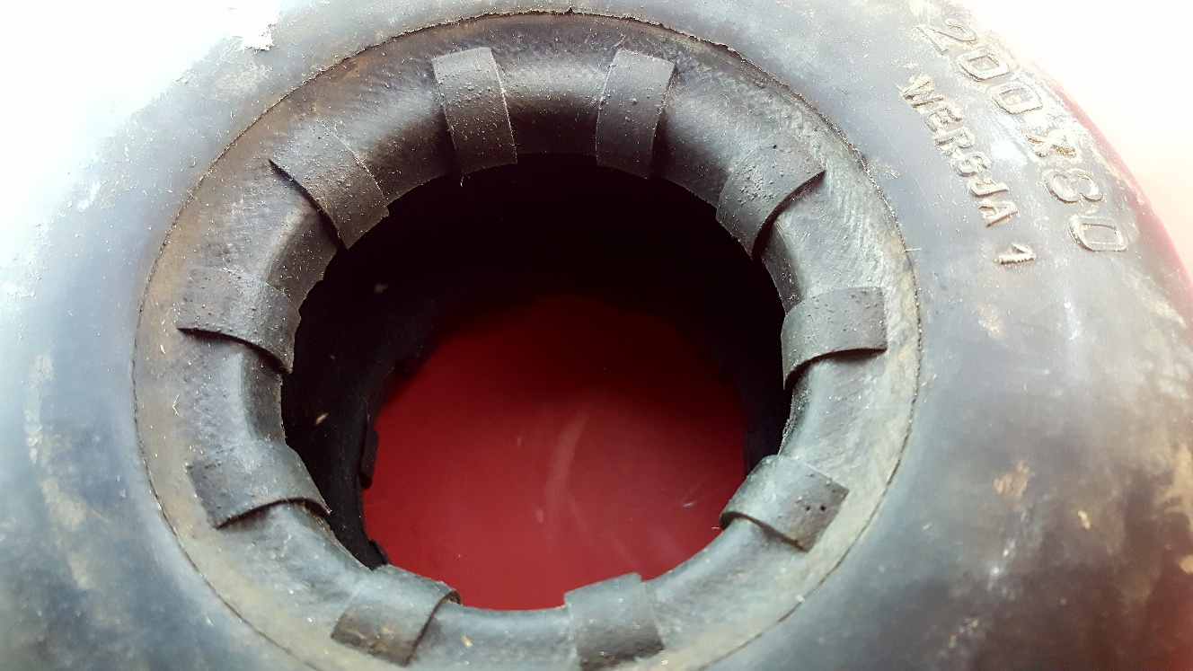

PostPosted: Thu Nov 30, 2017 2:15 pm    Post subject: tires for tailwheel Yak 50 Reply with quote
I have no idea if this picture will make it to the Yak-List, but it is sent individually to all who replied. If anyone else is interested, let me know and I will forward it.
In the picture you can clearly see the inner rim of the tire, that has indentations that exactly match the opposite indentations in the Russian wheel itself. I've never seen a design like this other than on Eastern Bloc aircraft. The Desser tire (80x200 smooth) does not have this design. It has a standard inner rim that is simply round and smooth. Putting that tire (Desser) on the Russian wheel will result in uneven contact from the tire to the wheel itself. What is the possible impact from that? In the worst case scenario, when the tire contacts the runway and comes up to speed, it would slip on the wheel itself causing the tube to be pulled, and the inflation tube to be broken, thus flattening the tire. That is the exact reason the Russians designed their wheels and tires the way they did. The indentations on the tire that mate with the wheel make spinning the tire on the wheel well nigh impossible. It is entirely possible that putting a smooth inner ring Desser tire on the Russian wheel would cause the tire to "form" to the Russian wheel simply by the pressure of the inner tube. That would be the best case scenario. The simple fact is that various people have put this tire on the Russian wheel (apparently) and nothing bad has happened yet! So it is an Experiment. And those with Experimental Exhibition aircraft really have nothing to worry about, more or less.
But the Desser tire is not a "perfect fit". It is the same size yes, but the design of the Desser tire was not ,meant to go on a Russian wheel.
Mark

Gents, there is nothing to agree with or disagree with here.
What I said is that Desser does not sell an exact replacement for the Russian tire. I did not say that they did not have another tire that would mount on the wheel. The assumption in a lot of cases is that every Yak aircraft is an Experimental Exhibition aircraft in the United States. That of course is not the case, and the rules in a foreign country are not the rules that we have here. This is why I was, and still am, cautious about suggesting to Jan (who does not live in the United States) that he put on any tire that happens to fit. There is a difference between "it will fit on" and it is "an exact replacement".
To be specific, I have no doubt that Royden is correct and that the 80x200 smooth type tire will fit the wheel. I also have no doubt that with a tube, the Russian wheel indentations will make no impact, since indeed this tire does not have a brake on it! If Jan's inspectors are OK, with it, then it is good to go. However, there is a chance that they will not. And this is one of those cases where if he put that tire on there, and then for whatever reason there was an accident, questions might be asked if it were discovered.
Just for grins I will take pictures and send them to explain what I am making a (small) point of.
