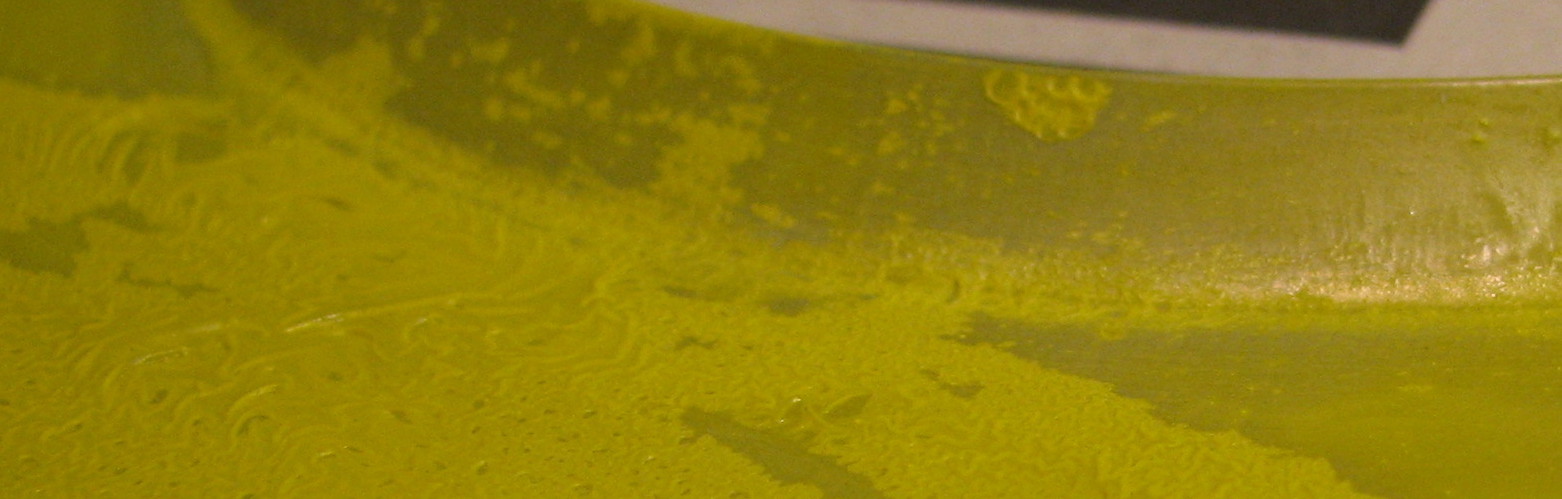

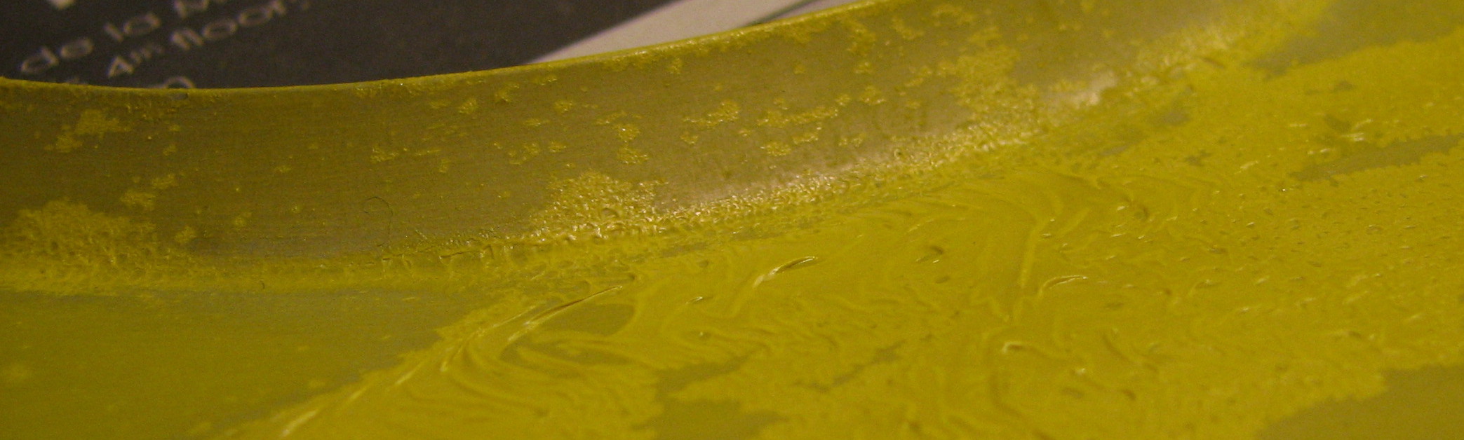

Hello, all
This is probably going to be obvious for a number of you.
I have applied a first coat of zinc chromate to some parts with a sponge brush.
In some spots, I get an ugly effect when applying the second coat.
It happens almost immediately.
All parts where previously scrubbed with scotch brite (color to remain unidentified), and then
swiped with a clean rag. I always wear gloves while working. Cheaper than H2O2 and band-aids. And
avoids fingerprints.
Any ideas what causes this? I see no apparent pattern...
Carlos
Montreal, Canada
CH601-HD, plans

Carlos,
You did not say how long the drying time for the first coat was. Is it
re-emulsifying with the second coat?
Somebody out there correct me if I am mistaken, but isn't two coats of zinc
chromate an overkill? It has been my understanding that a thin film is all
that is desired.
Gary Boothe
Cool, CA
601 HDSTD, WW Conversion
Tail done, working on wings....

Sometimes, too much is worst than not enough.
Just my opinion

Do you wipe down the parts with a bit of MEK before priming? If you don't
like MEK, who does, then you can try methyl hydrate.
Noel
