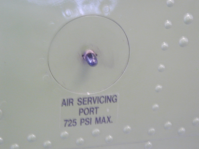

If you install this Schrader valve on the external air fill port cover, you won't need to use a spanner to open it up. All one needs is a standard aviation coupler that screws on to the end of the Schrader valve. This coupler is the same one that is used to fill struts with nitrogen on general aviation aircraft.
http://www.skygeek.com/schrader-6116-high-pressure-inflating-connection.html?utm_source=googlebase&utm_medium=shoppingengine&utm_content=schrader-6116-high-pressure-inflating-connection&utm_campaign=froogle&gclid=CLmBt7y_x8oCFYEmHwodEKwP9g
To install a Schrader valve on the external air fill port cover, simply drill the center of the cover and tap it with a 1/8 NPT tap. Remove the valve core when installed. Reinstall the cover on the airplane making sure the rubber grommet remains in place. If you need to use the Russian adapter, simply remove the cover from the fuselage. Attached is a photo of one installed on the external air fill port cover. (with the cap on the Schrader valve).
And here's the actual Schrader valve used.
http://www.amazon.com/Forney-75543-Valve-Schraeder-8-Inch/dp/B003X5Q8LY/ref=sr_1_3?s=power-hand-tools&ie=UTF8&qid=1453812935&sr=1-3&keywords=schrader+valve

 Filesize:  174.17 KB
 Viewed:  24530 Time(s)
dsavarese0812(at)bellsout
PostPosted: Tue Jan 26, 2016 5:32 am    Post subject: Air charging valve? Reply with quote
Seems to me your thinking is spot on, with one additional piece of info. Some M14 and Huosai powered aircraft will start with Nitrogen in the main air system. Some won't. My Yak was one that would not start with Nitrogen in the main air system.  Been there, done that, got the T shirt several times. Although I can't be certain, it may have been caused by the air start distributor timing allowing too much Nitrogen to be injected into the cylinder, thus causing an air/fuel ratio that was not conducive to combustion. Thus, having the Schrader valve on the external air fill port cover one could attach a Nitrogen bottle which can be found in many GA maintenance shops.
I made another post to this thread with a photo of a Schrader valve on the external air fill port along with a link to the coupler which attaches to the Schrader valve and a link to the actual Schrader valve used. The valve core is always removed because it is unnecessary.

PostPosted: Tue Jan 26, 2016 2:01 pm    Post subject: Air charging valve? Reply with quote
Chris,
You're thinking of this type of Schrader valve which does require a "spanner" to open.
https://cdn.shopify.com/s/files/1/0746/7711/products/airtec-H-4361-Shock-Strut-Valve_large.png?v=1434086615
But we don't use or need that type of Schrader valve. We use only a basic Schrader valve with the valve core removed.
http://www.amazon.com/dp/B003X5Q8LY/ref=dra_a_rv_ss_hn_xx_P1250_1000?tag=dradisplay-20&ascsubtag=27e62c756e24d097fd887e64a4fa0191_S
With the valve core removed, the Schader valve becomes nothing more than an adapter for the hose coupling from the compressed air tank hose to attach to. Remember, we have high pressure check valves on the back side of the external air fill port preventing the air from the main and emergency air bottles from escaping. That's why we don't need a valve core in the Schrader valve. Think of the valve core as a one way check valve which prevents the air from escaping.  Just like on a tire inner tube or rim. It allows air to go in, but not back out.
Dennis

PostPosted: Tue Jan 26, 2016 6:10 pm    Post subject: Re: Air charging valve? Reply with quote
Now that is a cool idea! How does the air get into the aircraft system from the valve stem on the cover plate? My Yak 52 is still getting overhauled in Russia, so I don't have an aircraft handy to look at.
I think you are quite brave using a brass fitting for this application; the maximum working pressure listed for this fitting is 200psi!!
PostPosted: Wed Jan 27, 2016 4:42 am    Post subject: Air charging valve? Reply with quote
The working pressure is limited only by the valve core. Certainly not the brass fitting. So there is no bravery involved. Since the valve core is removed, there is no limitations associated with the brass fitting.
Inside the cover plate is a thick rubber grommet. The cover plate presses up again the rubber grommet. The rubber grommet remains on the aircraft when the cover plate is removed and is/was used for the Russian air fill adapter. We just make use of what is already on the aircraft.
Dennis

PostPosted: Wed Jan 27, 2016 9:01 am    Post subject: Air charging valve? Reply with quote
Dennis-Do you have any pictures of this valve set-up?
On Wed, Jan 27, 2016 at 5:36 AM, A. Dennis Savarese <dsavarese0812(at)bellsouth.net (dsavarese0812(at)bellsouth.net)> wrote:
On Wed, Jan 27, 2016 at 5:36 AM, A. Dennis Savarese <dsavarese0812(at)bellsouth.net> wrote:
Dennis

PostPosted: Wed Jan 27, 2016 11:28 am    Post subject: Air charging valve? Reply with quote
I posted the only photo I have to the Yak list 2 days ago. It shows the Schrader valve affixed to the external air fill port.
Dennis
