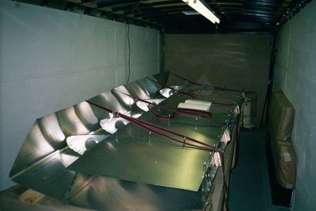

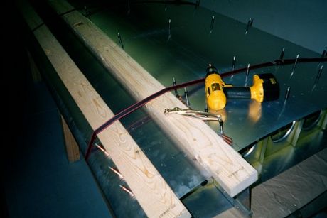

For the stabilizer, I just used nylon straps that I got at Big Lots for a couple bucks a four pack. These are about ten feet long and have a metal buckle at one end that you slip the other end through twice to cinch. The same type buckle used on back pack strap. They are easier to use than a ratchet strap and work just fine for this job. I cut slots in my work table with the circular saw and threaded the straps down through the slots, under the table surface and back through slots on the other side of the stabilizer. Then I just pulled the snug a little at a time, keeping the tension on all of them even. I think I used four of them for the stabilizer and put a length of 1 by 2 lumber under them to distribute the force to the skin.
I used the same straps for the nose skins on the wings but I had to string two together to get the length I needed. I used four sets of these straps to do the wings with a couple of 12' two by fours under them to distribute the load.
