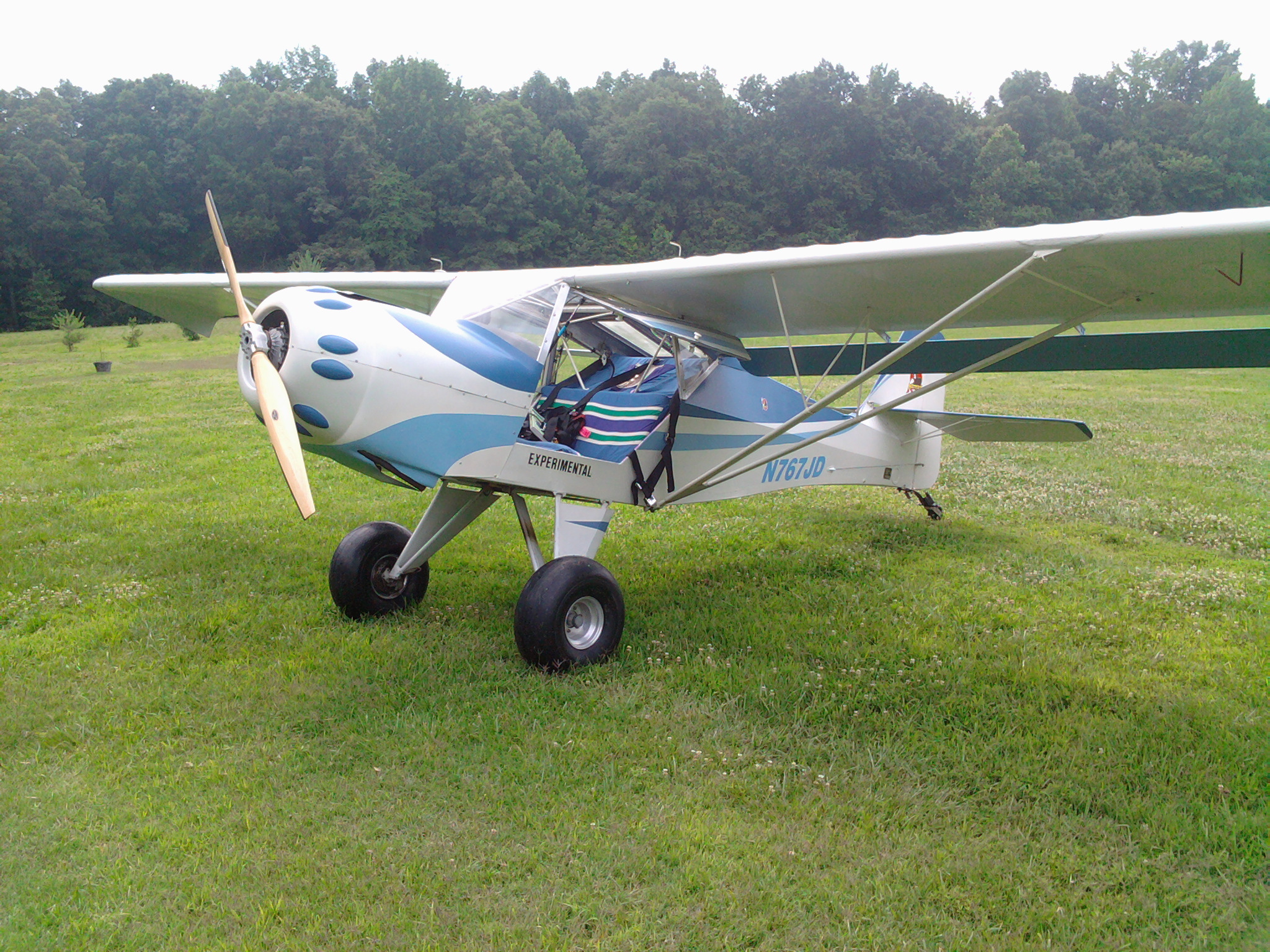

Funny to find this thread. I just flew around the patch for the first time with my Kings, that I bought a few years back. Came to the forum to ask WASSUP with the bouncing? Seems my gear is now all spring and no shock absorber. I put 8 PSI in them and came here to ask opinions about whether to add some or take some out.

I started the same tire at 8 lbs with the same results on my kitfox IV. I started lowering the pressure and am now at 4 psi and it works great. Pressure seemed to have a big bounce effect for my style of landing.

Jeff, Have the same tires at similar pressure on bush gear. I bounced mine in for a long time. No more. Here's a hint. It ain't the tires causing the bouncing.

I agree, it ain't the tires. I've had the same tires on a Model IV with Grove gear
for 5 years. Bounced at first, but don't anymore.

Jeff,
I tend to agree with Pat on this one.
I run 10 lbs in mine (also with the bush gear) and have no problem bouncing unless I screw up the touch down which I do on occasion (OK...maybe more than occasion)
Its all part of flying !...no big deal.

Nice airplane, Jeff. Generally the amount of air in the tires has nothing to do with bouncing. Usually the problem will go away when you slow down your landing speed a bit so that it stalls about the time you touch down.
Good luck.

I have not had a chance to try it again, but I did lower the pressure to 4 PSI last night. One of them just kept on going after that. Was flat within 1/2 hour.
The common theme I am hearing is the soft touch. I can grease them all with a wheel landing, but the three point is still a matter of luck, as much as I try. Am all ears about what I am missing, but think I have heard it all and I think I understand what is going on. At that AOA adjusting pitch to go for the soft touch won't work, I have to learn how to use the throttle to stop it from dropping in, or get the timing right on the roundout. Mix that with a strong crosswind, and the only technique I can think of that guarantees control in a Model 2 at three point speeds is luck. Add a gust, and forget it. I work on it occasionally, but if I lack currency, often the case, I take the less risky way out and wheel it. Already ripped the gear off once, do a search. For me, this a challenging bird, and I have flown a lot.
I have gathered parts for a Model IV in my hangar. I have heard a couple of comments about the bush gear that suggest it is more forgiving, might choose that.

Maybe I will try 10 PSI. I was halfway expecting the answer to be a higher pressure to firm them up. 10 is the max printed on the tire.
