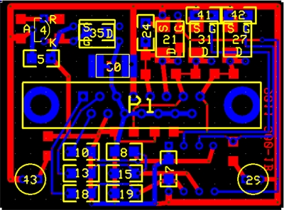

Fred,
During the review of design goals on your idea
you mentioned the possibility of using a PIC
micro-controller to accomplish the task. I mentioned
a "do lots" board and enclosure that could
be useful to your efforts. The schematic for
the board is . . .
http://aeroelectric.com/Pictures/Schematics/Do-Much_Board_Schematic.pdf
If you want to massage it in a cad program . . .
http://aeroelectric.com/Pictures/Schematics/Do-Much_Board.dwg
Obviously, if you put ALL the parts on the board, there
would be some conflicts of functionality. However,
depending on what parts are put on, what are left
off, values of parts and nature of software installed
in the 8DIP PIC, you can "Do Lots" . . .
[img]cid:.0[/img]
The board is being re-configured to accept surface mount
power FETs as opposed to the 4DIP parts shown.
The whole thing fits into this enclosure
http://www.aeroelectric.com/Catalog/AEC/9011/A15_Package.jpg
I think there's room under the board to let you jeep
a TO247 power FET into the enclosure . . . depending
on a refinement of design goals and preliminary design
review, this combination of parts might save you a lot
of time and offer a good finished product.
Use as it suits your needs.
