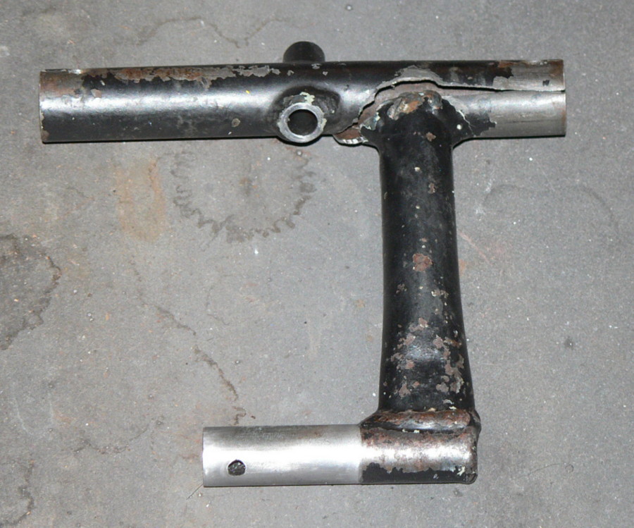

I have had a very fortunate incident. A week ago Saturday my tailwheel assy broke. I had flown for 2.6hrs, done three off field landings and returned home without incident. I folded up as I always do, but as I slipped the hairpin clip into the wingfold tube on the second wing, both wingtips hit the ground. The down tube that the tail wheel is mounted on folded back.
Inspection shows that there had been a crack on the edge of the weld underneath the crossbar at the leading edge of the downtube for a while (no rust, but darkened metal.) After the days flying and 322hrs, the extra weight of the wings on the tailwheel spread the crack to the end of the tube and that was that.
I have since tigged up a new one with thicker 4130 tubing using ER80S-D2 filler rod and some pre-heat. The new one is painted a light color so that any cracks will show up easily.
Just a heads up to the list. Chances are there may be other cracks out there. I have included a couple of pictures below.
This is a shot of the failure before anything was moved.

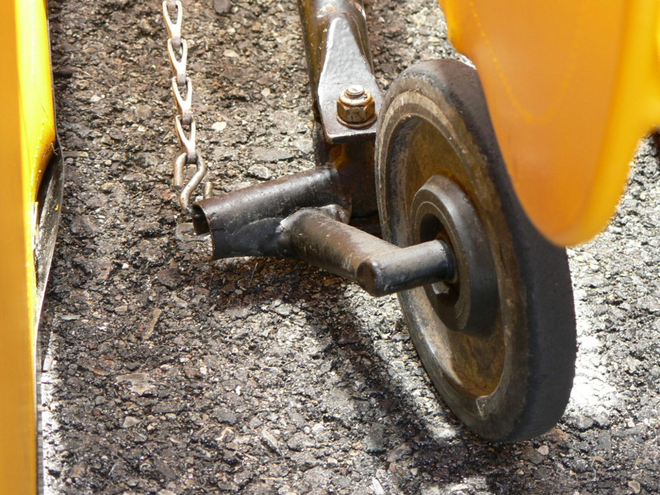

Modified tail wheel assembly. Took this picture in 1999 - before I went flying.
Second flight - and it fell-off in the air somewhere?
"You" might notice that the axle has already slipped half out of the
bracket (I didn't).
I was just taking pictures of my new plane for the "Kolb List".
Forgot the cotter pins. No harm done....grass strip.
There goes another $5 "grocery cart" wheel and a $20's worth of bearings.
http://www.mindspring.com/~possums/Tailwheel.jpg

Not that I know of. I have come home with a few weeds in the tailwheel, but not on this trip. The landings were off field, but not on rough ground or with tall weeds. The crack was no older than 2 or three weeks, as I washed the plane about that long ago, and there was no rust in the crack. In my area, bare metal rusts in a hurry. I still can't believe it waited till I was folded to give up. Good luck is hard to come by. I'll take it when I can get it.
