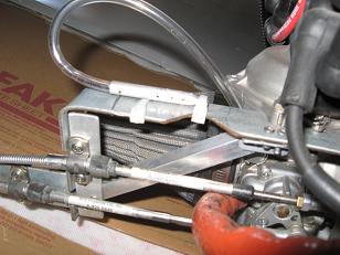

Over the past few months I've been struggling to get my CHT's below 360Deg. and EGT's below 1400.. Way too lean.
I saw the post about the static port for the tube into the carb and did that after I spoke to Jim at Jabiru Pacific. when the tube was inserted into the air filter it apparently caused a negative pressure drop that kept the mixture lean.. Ok, fixed that.
I've changed my main jet to 240 and needle jet to 2.85..
I put the baffle's on the front of the airscoops.
I use the EIS that has 4 CHT's and EGT's .
Today I flew and got 340deg in climb with 1350EGT's max.
In cruise the rear left cylinder was hottest at 335Deg and EGT's were just under 1300.
I'm getting there!

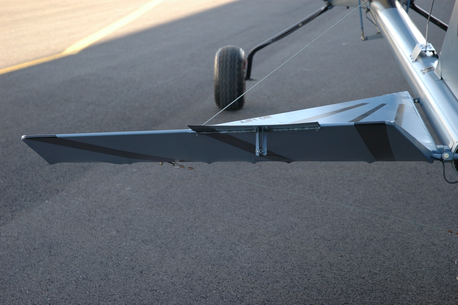

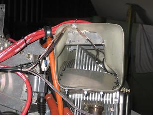

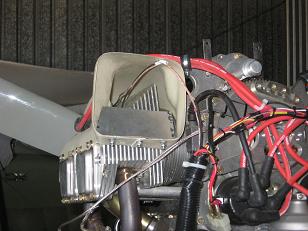

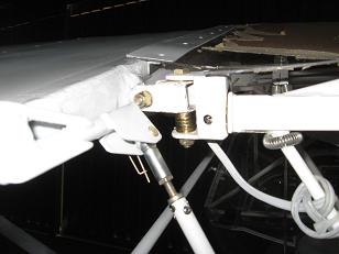

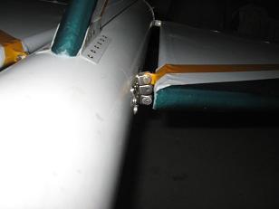

I've included pics of the static port to the carb and also my current wing and tail angles .
Finally getting to just fly the plane and not mess with it.
If you guys have any other ideas, I'd love to know what works well.
Tom, you said you use 250 main and 2.90 jet? Maybe I can go somewhat richer.

Thom Riddle
Posts: 1597
PostPosted: Sat Oct 01, 2011 3:21 pm    Post subject: Thom, Chris or Jabiru owners Reply with quote
FrankD,
I know you said that Jabiru Pacific said to do the "static port" the way you show in your photo but ALL the Jabiru's I've ever seen or heard about have the float bowl vent (not static) connected to the inside of the air cleaner by way of a the end of the conical air filter. In other words, the tube from the float bowl vent goes into the end of the air cleaner so that the float bowl has the same air pressure as the inlet side of the carb. Not sure why Jabiru Pacific recommended you do it that way. I didn't hear anything about doing it that way from Pete Krotje two weeks ago in his seminar. Maybe that is an accepted alternate way of doing. Beats me.
When I replaced the Bing jet needle with the Jabiru jet needle I changed the needle jet (cruise jet) to 280 and the main jet to the closest to recommended(220 to 250) by Jabiru that I had on hand, #255. Configured like this, at low altitude, my cruise EGT is right on the target 1325F. It gets richer as I climb to higher altitudes. Only during my first flight after this change did I still get a hotter than desired EGT during WOT climb at Vy. On subsequent flights, inexplicably, the WOT at Vy EGT was colder than target, so I might go to a bit lower number main jet, maybe.
Thom

Thom Riddle
Posts: 1597
PostPosted: Sat Oct 01, 2011 3:23 pm    Post subject: Thom, Chris or Jabiru owners Reply with quote
FrankD,
Forgot to mention in previous email. In these photos, it looks to me like the deflectors at the top of the duct are vertical. This could be an optical illusion since the photos is taken head on. In any case, they should be angle back(at the bottom) roughly 45 degrees or so, not vertical and the one over the front cylinder should be shorter than the one over the aft cylinder to allow air flow to reach the aft cylinder deflector. These are just general recommendations so if your CHTs are in line the way you have them, then great! As I stated before, my CHTs typically run 270-290F in cruise. You may or may not get them that low. As long as they stay in the green, that is good.
Thom

I'm getting there!
FrankD

Hi Thom,
thanks for the feedback.
The top deflectors are about 60Deg angled back.. Since the back cylinder was the hottest, i took the front deflector off today , to try to balance out the temp difference.
I would love to be under 300 Deg CHT in cruise, thats my goal.
So I think I'm going to try slightly bigger jets and continue to work the baffles.
If I can get the radio noise down and a real Trim tab for the elevator, that would be the best of all worlds.
Fun, Fun..
thanks for all feedback, if anyone else has the jabiru magic set-up, I'd love to hear about it.
Rgds
Frankd

FrankD,
Did you get the Jabiru needle installed yet? I was unsuccessful with the EGTs until I replaced the needle.
You mentioned elevator trim. My SS has a very good one installed by the builder. Attached is a photo. If I needed one now though, I would probably just rig an adjustable bungee in the cockpit. Simple, cheap and works as well as an electric tab with no extra weight on the tail or complexity of wiring. That said, it turns out my SS hardly needs one solo, which is the only way I fly it. My trim setting at cruise is the same as required on final approach with flaps. Only in between those two extremes is it slightly out of trim and not worth bothering with.
I was also fortunate regarding radio noise. The builder of my SS is an electrician by trade and he did all the right things with wire routing, grounding, shielding, etc. My handheld iCom A6 with ship's power and airframe mounted antenna has no ignition or other noise whatsoever.... other than the engine/prop, of course.
Thom

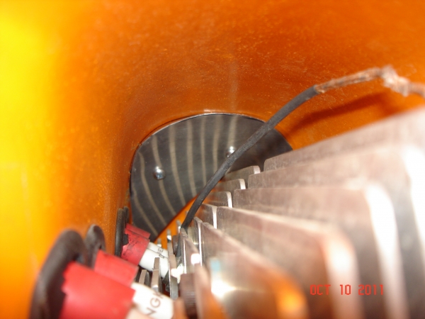

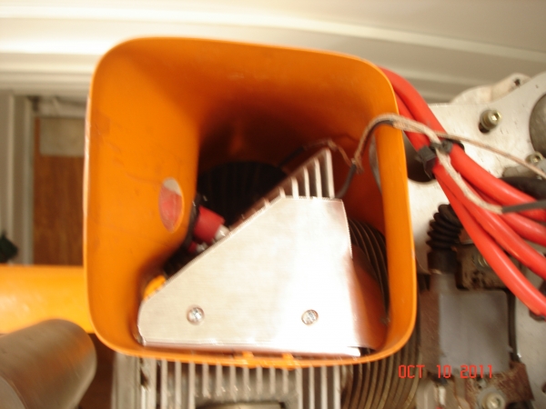

Well, I finally built some baffles. I built a front and rear only and only on the cylinders 2 and 4 bank. I only have 2 cht probes so I moved them both to that side so I can tweak it as needed. I went and flew for an hour and could not get the chts on either one over 330 to 335 and that was climb to 5k ft at 60 mph. At cruise the hottest one (the back cylinder) was anywhere from 295 to 305. So far the results are good, still need to work at it though.
Travis Bennett
