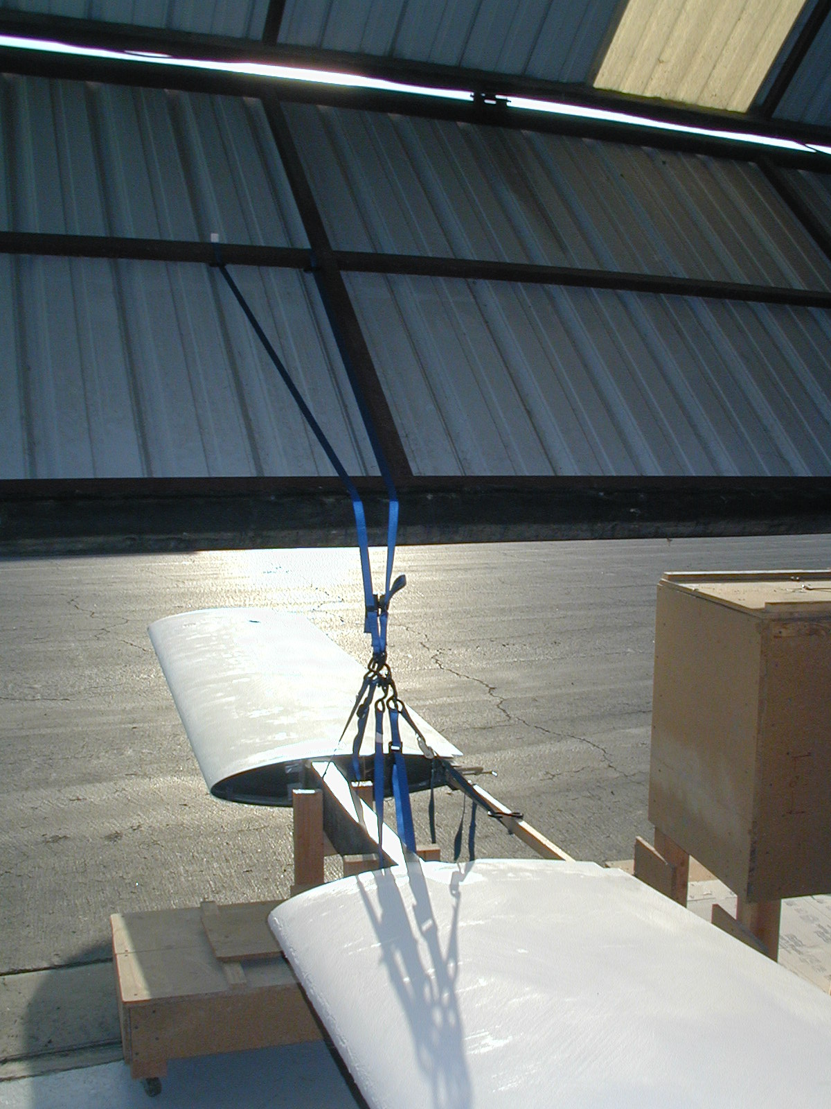

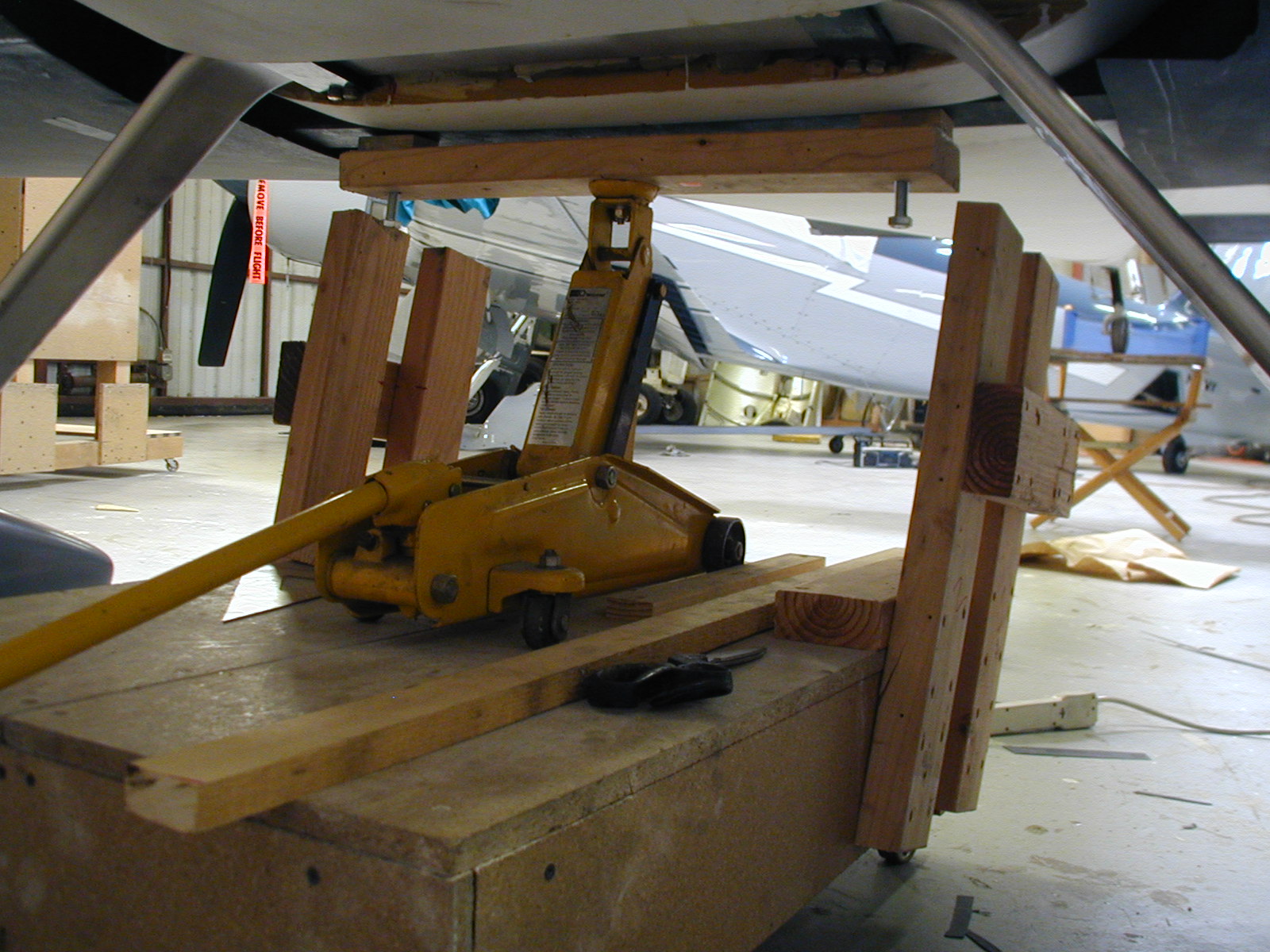

Here's a picture of the rig I built to install and remove my wing. I removed and installed the wing by myself dozens of times. The final iteration had the 2x4s vertical instead of angled (originally I made to remove the wing with the tail down). I also had temper foam where the wing rested in the cradle. It's on wheels which makes the wing easy to move around.
Scott

Hello Scott, Thanks for the pictures.
Your picture of the wing being held up by a jack setting on a structure made
of particle board, 2 X 4's, and drywall screws reminded me of a thought that
went through my mind a few times while building my KIS TR-1 and the various
temporary jigs that I constructed with plywood (much of it from the original
KIS delivery crate), 2 X 4's, and drywalls screws:
"If you give me enough plywood, 2 X 4's, and drywall screws I bet I could
build an Empire State Building." It might not be very usable, but it would
be up there.
OC

PostPosted: Wed Mar 09, 2011 4:23 pm    Post subject: KIS TR-1 Wing Removal and Installation Reply with quote
Hi OC,
I've seen the bamboo scaffolding in China when I was there with Mark 10 years ago. 30 story buildings with bamboo scaffolding tied together with some kind of a twine. Not a nail or screw in it.
The box with the jack had a base of 4x4s and was quite solid.
Scott
