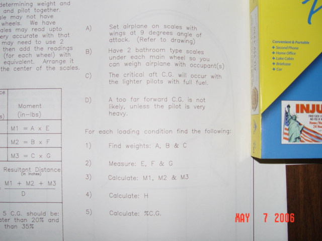

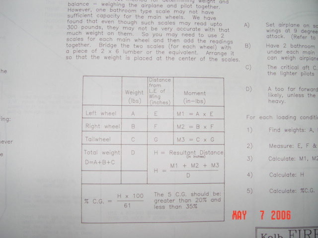

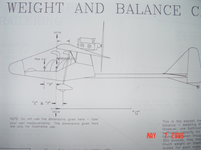

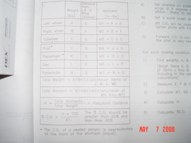

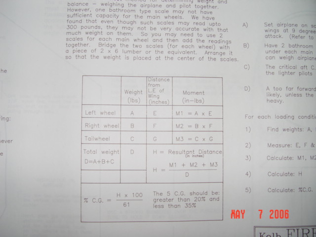

Here's the print...

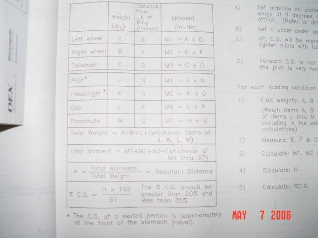

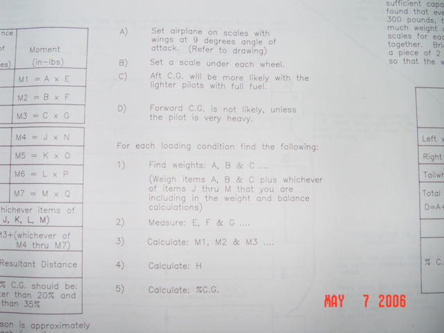

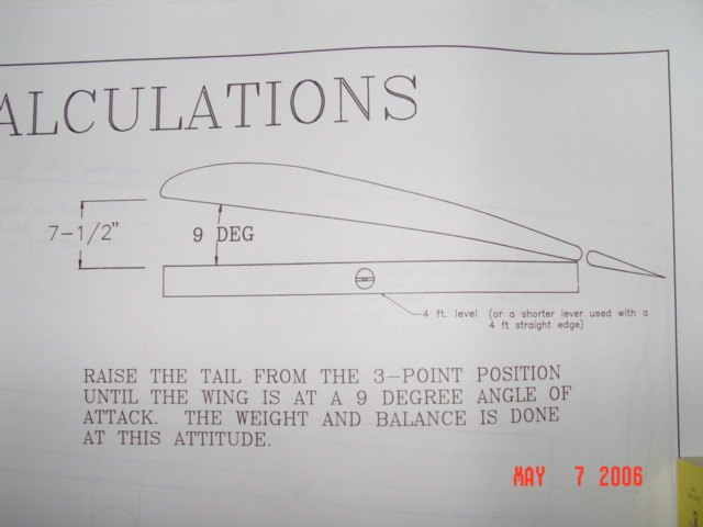

Here's the rest of them...
