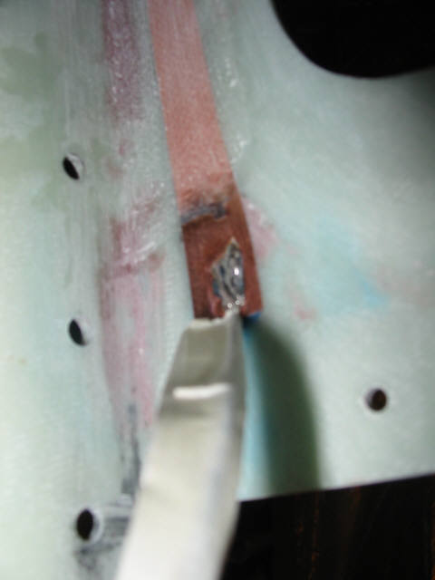

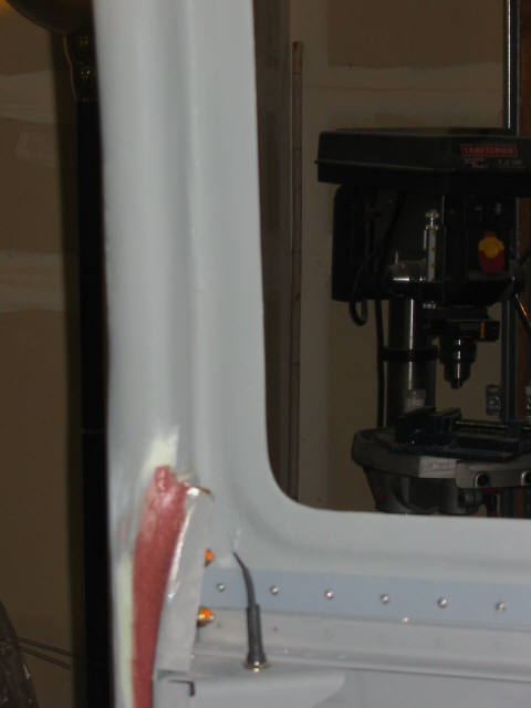

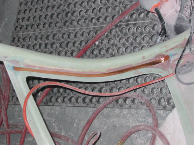

I mounted the low drag VHF comm antenna in the canopy for use with my #2 radio. I have a bent whip on the belly of the plane for my #1 radio. I glassed it to the inside of the canopy top, just aft of the right door. This antenna is supposed to be vertical as much as possible and that is the best place I could find an almost vertical 23" surface. After sanding, filling and painting it just disappeared and looks great. I hooked it up to my VHF handheld and have been listening to airline traffic in and out of Boise from my garage... as far as I can tell it works great. Fiberglass does not blank VHF transmissions - however I believe certain exterior paints (metallics?) might have some effect. The reason I did not want to use this for my primary radio is the considerable blanking you get from the aluminum portion of the fuselage, but it should be fine for a backup.
Additionally, I plan on glassing the VOR antenna in the wingtip. That is a horizontally polarized signal and should work great there. Plus there is much less blanking from aluminum structures way out on the wing tip.
Pictures attached.
Jim

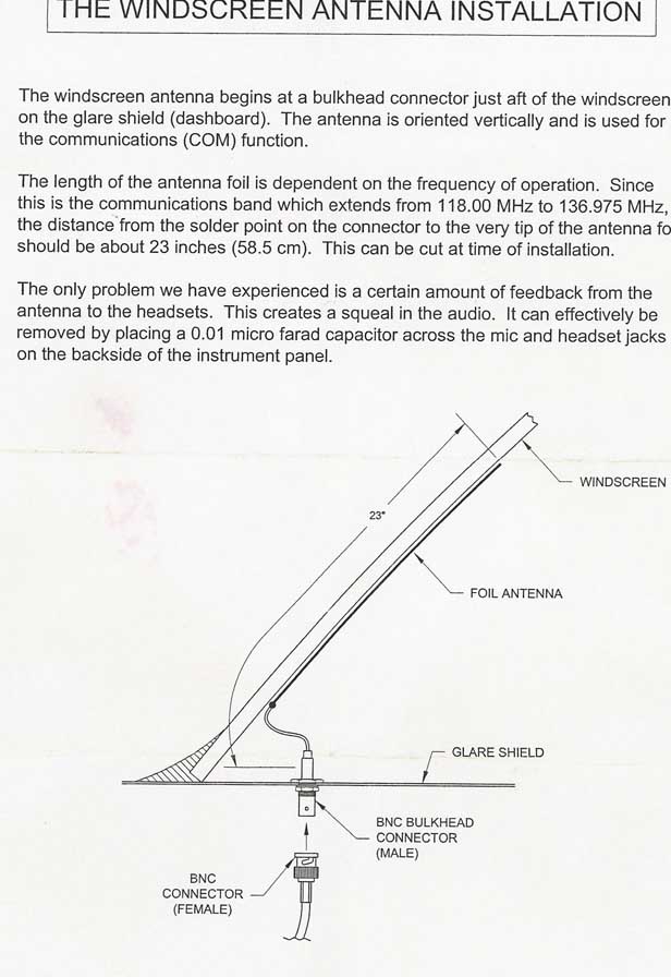

Thank you for the response. Very clever installation. One more question, what did you do about a "ground plane"? Is one recommended?
Roger
JSMcGrew(at)aol.com
PostPosted: Sun Apr 16, 2006 1:52 pm    Post subject: Low Drag VHF Antenna Reply with quote
I believe the ground plane requirement is covered by the antenna coax connector (included in the antenna kit) which is bolted to the aluminum part of the airframe. There is no mention of ground plane in the sheet Van's included with the antenna kit.
Jim

Makes sense that bolting the connector to the frame does the trick. I didn't receive a sheet with the kit from Vans. Guess that is why the questions. Could you please send a copy of it to me? Thanks a bunch. This list is great!

File attached.
-Jim
