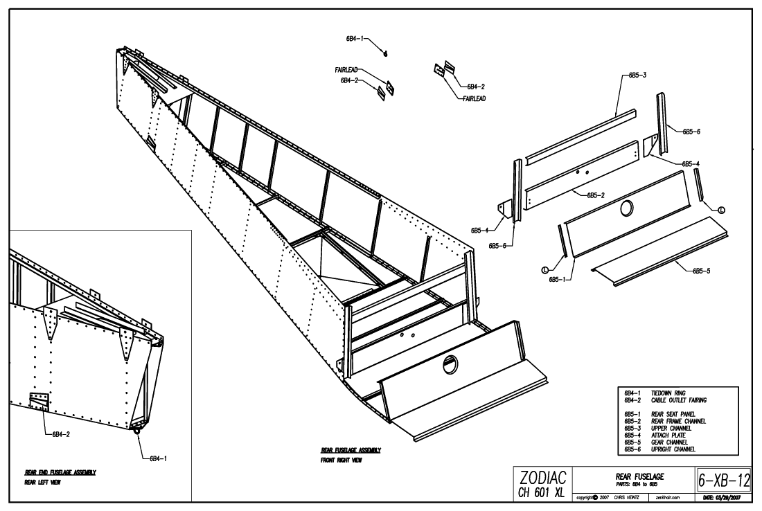

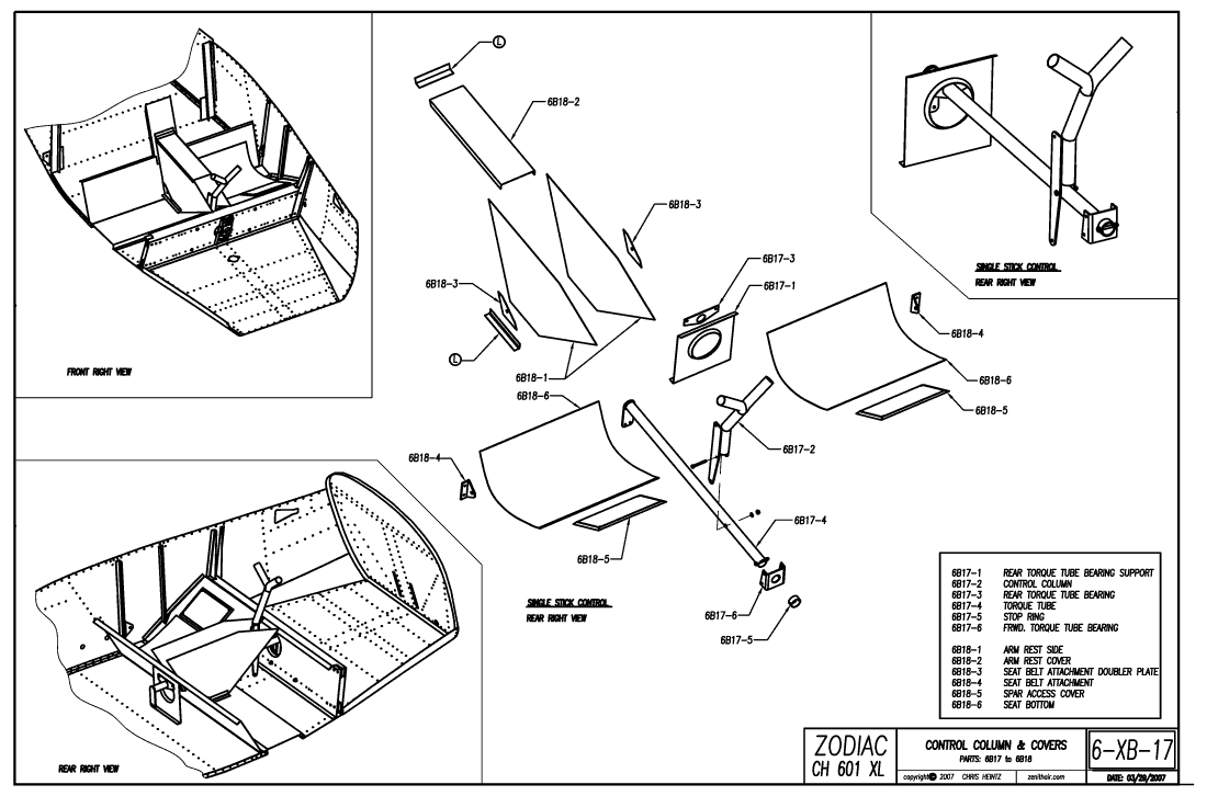

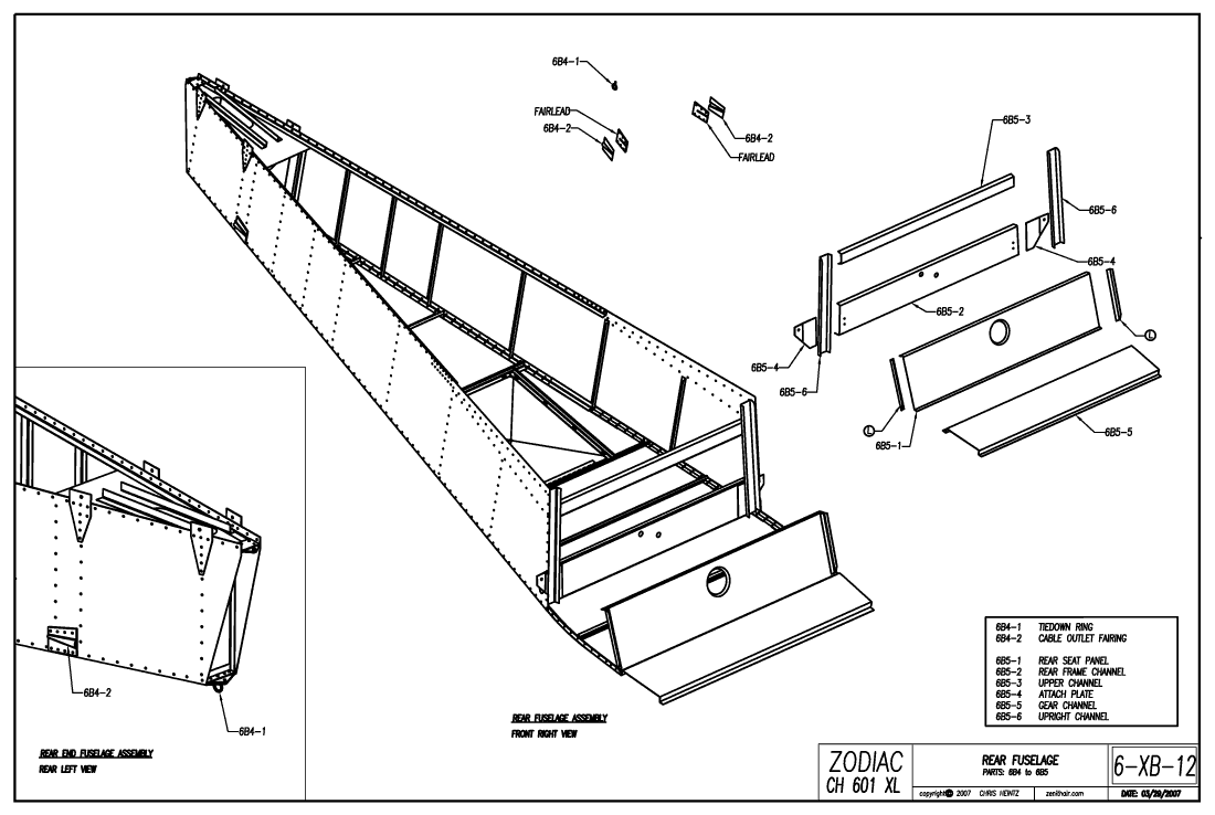

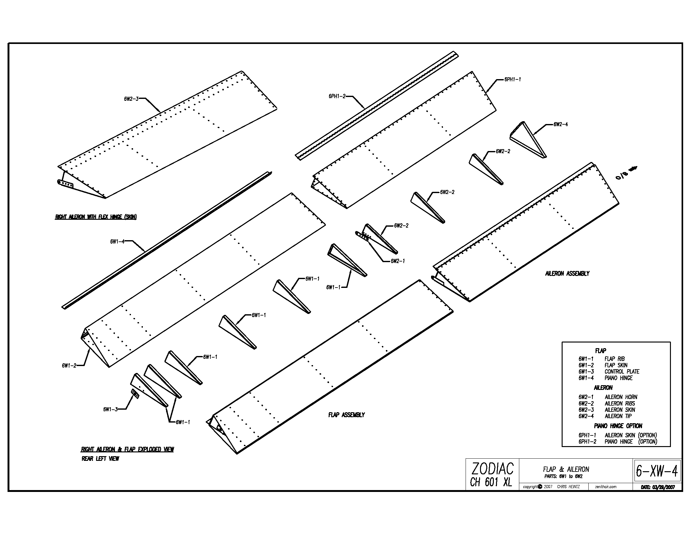

PostPosted: Thu Jan 01, 2009 2:01 pm    Post subject: Re: XL wing concerns Reply with quote
Sabrina, the aircraft was built as per ZAC drawings in order to qualify as LSA class.
How would one know if any of the parts below were "changed"? Please clarify what it is you want to know.
Sabrina wrote:
David,
Which CZAW version do you have?
Is your rear spar attach lowered?
Is your center spar modified per the CZAW plans shown above?
What is the thickness of your rear side skins?
Not protesting, just gathering information... :o)
Same question to you as Martin... David: Are any of these items changed as well on your version of the CZAW 601XL? 6B-5-1, 6B5-4, 6B5-6, 6B-5-2, 6B-18-1, 6B-18-3, 6W-1-1,6W-1-2, 6B-11-2

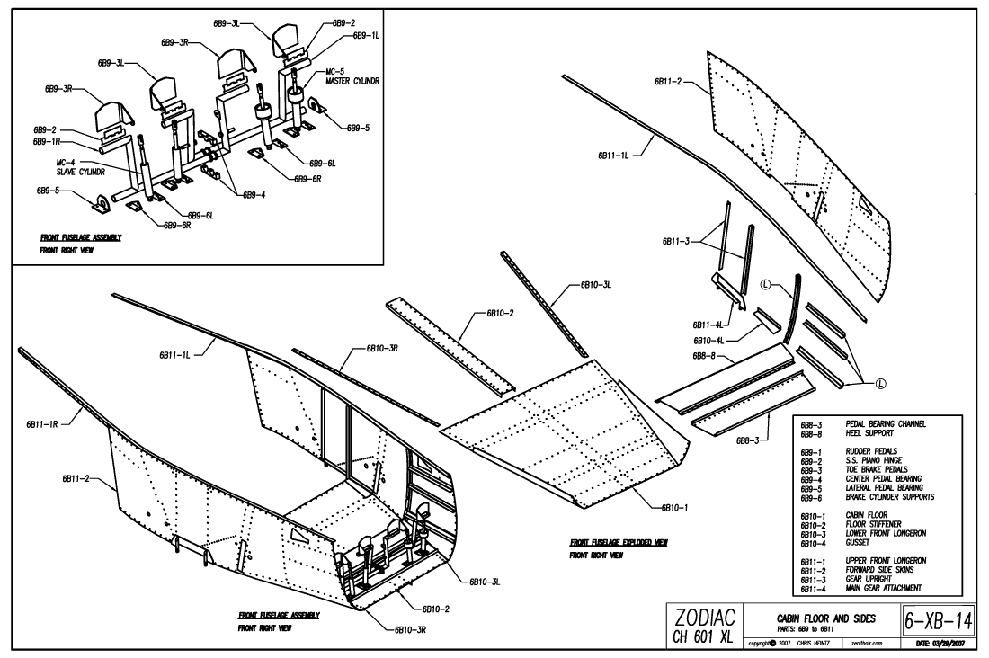

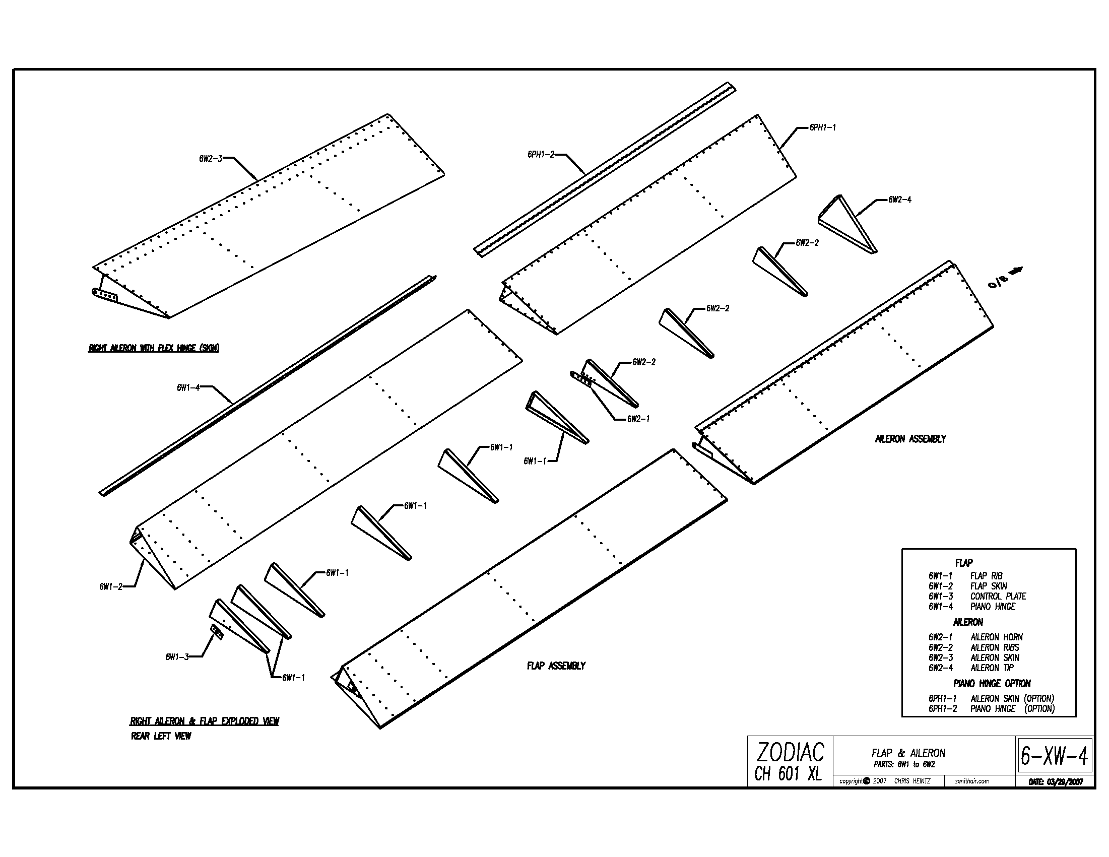

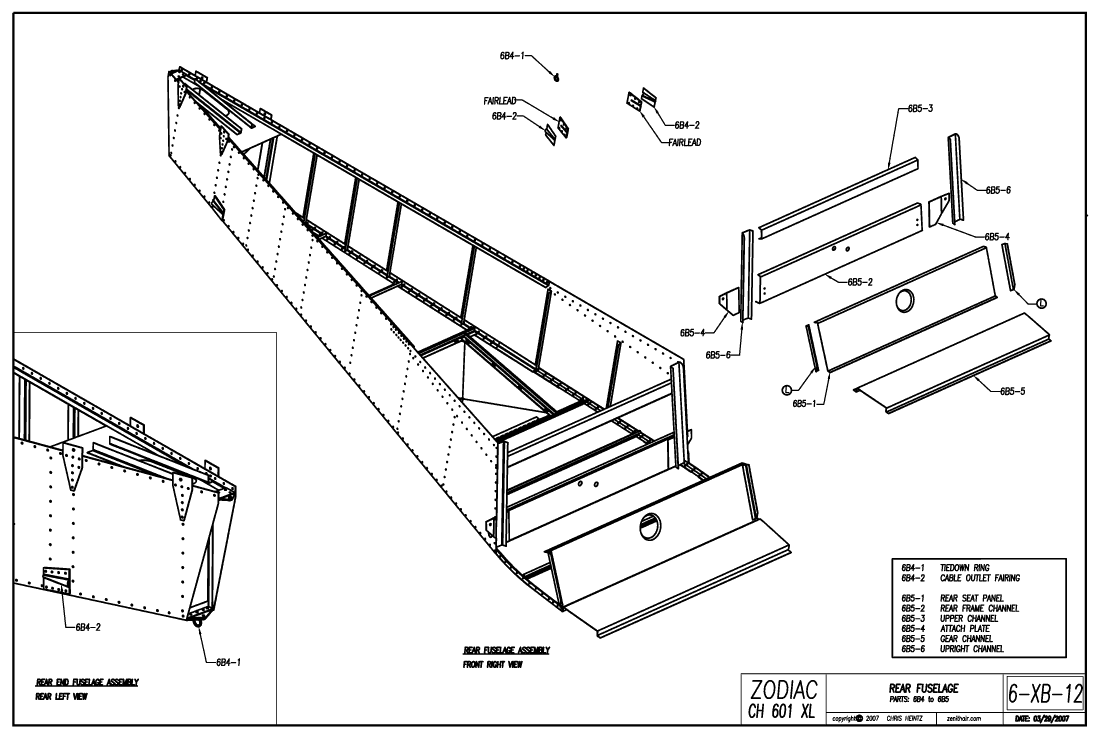

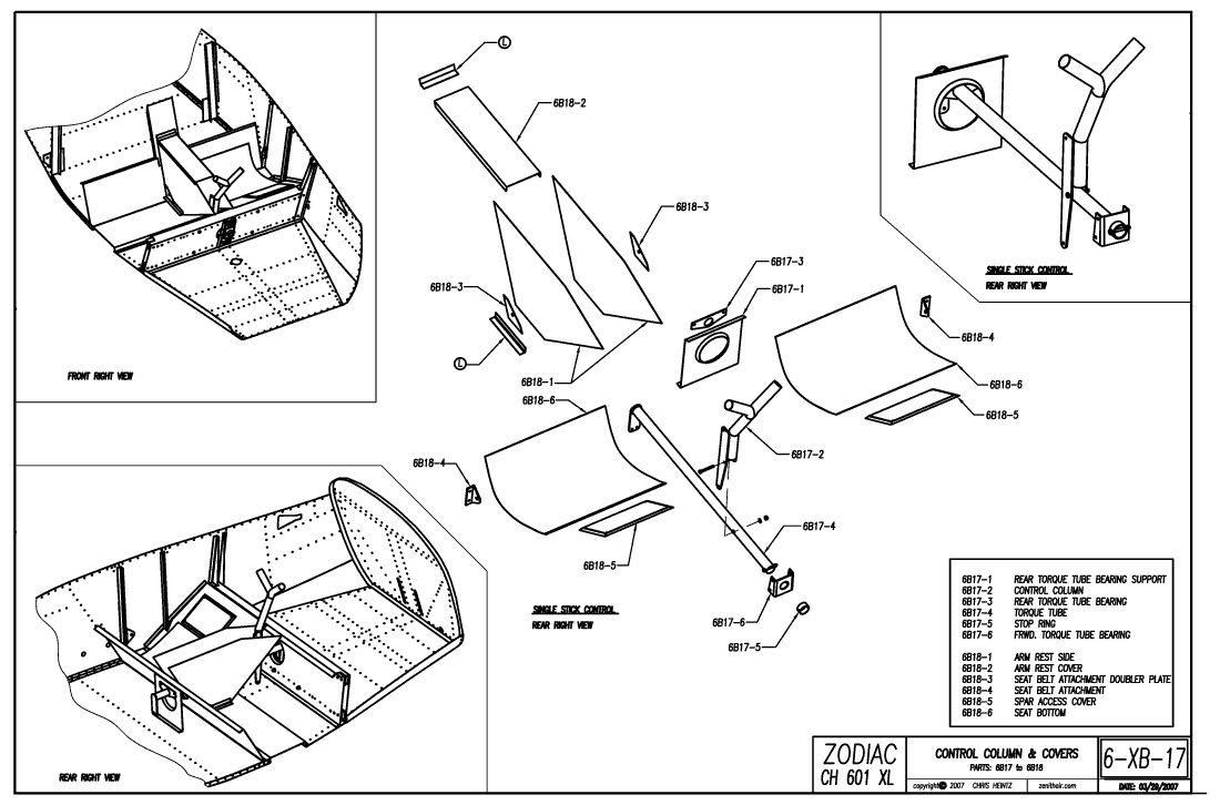

PostPosted: Thu Jan 01, 2009 2:36 pm    Post subject: Re: XL wing concerns Reply with quote
I see that you are referring to the rear spar and attach points (6b5-1,2,4,6), the center arm rest (6b18-1), the seat belt attach points (6b18-3), flap rib (6w1-1), flap skin (6w1-2) and forward side skins (6b11-2). (see attached)
What specifically information are you looking for?
 Filesize:  42.02 KB
 Viewed:  945 Time(s)
 Filesize:  48.23 KB
 Viewed:  895 Time(s)
 Filesize:  51.43 KB
 Viewed:  873 Time(s)
 Filesize:  39.4 KB
 Viewed:  919 Time(s)
