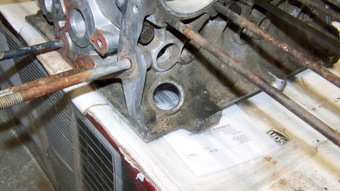

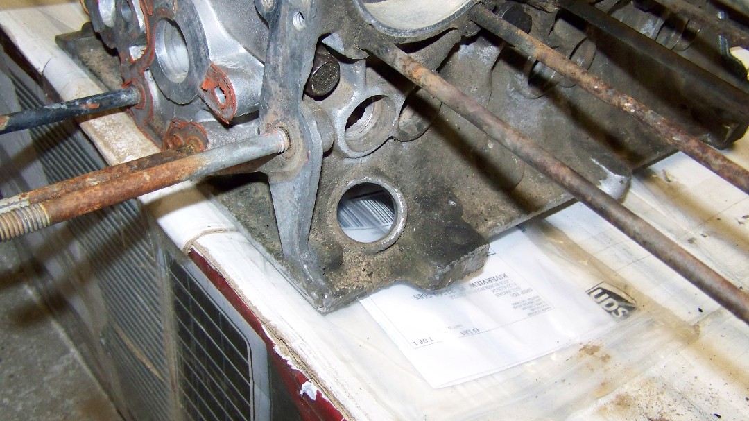

Picked up another Corvair block and it is different than the one I already have. Can someone tell me what the hole below the lifters are in the attached photo?
Bill Pagan EAA Tech Counselor #4395
601XL QBK/Corvair/N565BW (RES)
 Filesize:  296.05 KB
 Viewed:  606 Time(s)

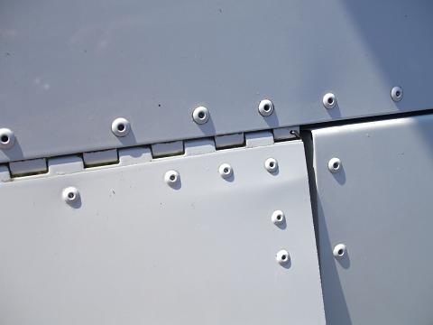

PostPosted: Thu Dec 18, 2008 5:16 am    Post subject: Re: Simple rivet test/unzip Reply with quote
gusset are to prevent similar to this
 Filesize:  23.08 KB

Sometimes aluminum structures that bend, change the rivet load from
shear to tension. With A4's once you get a bit of bending, then your row
of A4's become the aluminum equiv of velcro. A5's, and Solids do not
do this. The laboratory perfect shear load, is rarely the case in real life.
If you have a hinge holding an assembly on with A4's a hard shake might
be all it takes to get the rivets to start popping. (flutter for example).
Personally I think the rivets should be stronger than the metal that they
are fastening.
Somebody mentioned A5's are heavier? You could change every A4 to
an A5 and the weight difference is probably less than what you gained
eating over the holidays ...
Jeff

I'm curious to know if anyone would consider the larger holes drilled,
say in using A5s in place of A4s, to cause the skin to be more prone
to tearing.
I thought on reviewing a fastener chart posted yesterday that even A4s
weren't listed for .016" skin. Biggest was A3s.
Thanks, Ron in L.A.

a larger hole necessarily produces greater bearing strength as long as the edge distance is adequate. The recommended fastener sizes are for the design of a balanced joint - one that has approximately equal strength in shear (fastener failure in shear) and bearing (skin tear out) for the thinner element assembled.
That having been said, the rivet spacing is grossly above the the best balance spacing on not only the Zodiac but also most of the other designs on the market. Also, as has been pointed out previously, adding the full complement is not unacceptable and has only a minor weight impact.
I have always designed structure and repairs with the bearing failure as the clear mode of failure. At least then you know the loads that the failure will propagate at in both pre and post buckled states to within a reasonable tolerance. The other way you have to assume that the structure is loading without local deflections that load the fasteners in unstable ways - zipper mode.
David L. Downey Harleysville (SE) PA, USA

Jeff, somewhere in Zenith's literature, I forget where, they address the
practice of making countersunk rivets domed, with the special-cut nose. It was
to work harden the head of the rivet. Adds some strength. OPINON--Any guy who
would go to the level of detail of figuring out how to develop more strength
in a rivet, has probably extended that attention to detail to bigger things,
like spars and attach points. Until somebody proves otherwise, I'll go along
with CH.
