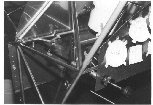

PostPosted: Mon Nov 24, 2008 6:46 am    Post subject: Left Side Throttle Reply with quote
Subject: Re: Left Side Throttle
Hi Jim,
I moved my throttle to the left during construction. It was easy to do and
I
love it. An old FAA safety article stated accidents were being caused by
wrong control inputs during innitial test flights. It stated that anyone
who
learned to fly in a stick & rudder plane with left throttle may
unconsciously push forward on the stick when throttle input is needed at a
stressful moment. My left hand rests on my left knee comfortably and I can
easily screw in or out the throttle for inflight changes. I'll see if I
have
photos for ya.
Ron 55KF Schaumburg IL
