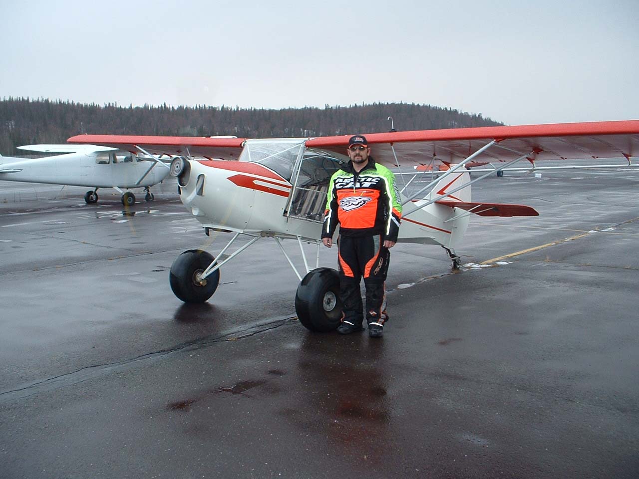

After a few years under a tarp, I rescued N61PW from going to the dump. 2 years later, after an extensive rebuild and lots of real bad swear words I got to give her the first flight today. She came out a portly 581 pounds even after I removed a bunch of crap the original builder had installed... but I think I added back all but 3 pounds by using medium weight fabric and putting on 24" aircraft tires (heavy buggers). It came out with a CG of 11.8". I will be putting a survival pack together and putting it as far aft as I can in the extended bagage area (goes back to the front of the vert. stab.)
All in all it has been alot of fun, but more work that if I had bought a new kit... Today made all the cuts and burns worth it when she broke ground and did not have any bad habits.

Leonard, very nice looking bush plane. Do you hand prop to start it?

No sir, I have the clutch... I am trying to figure out a way to be able to lock it up in the event of a battery failure out in the boonies... I have to pull it apart next time home and see if I can drill and tap the clutch so set screws can be run in to prop it in the event that I lose a starter or battery.
