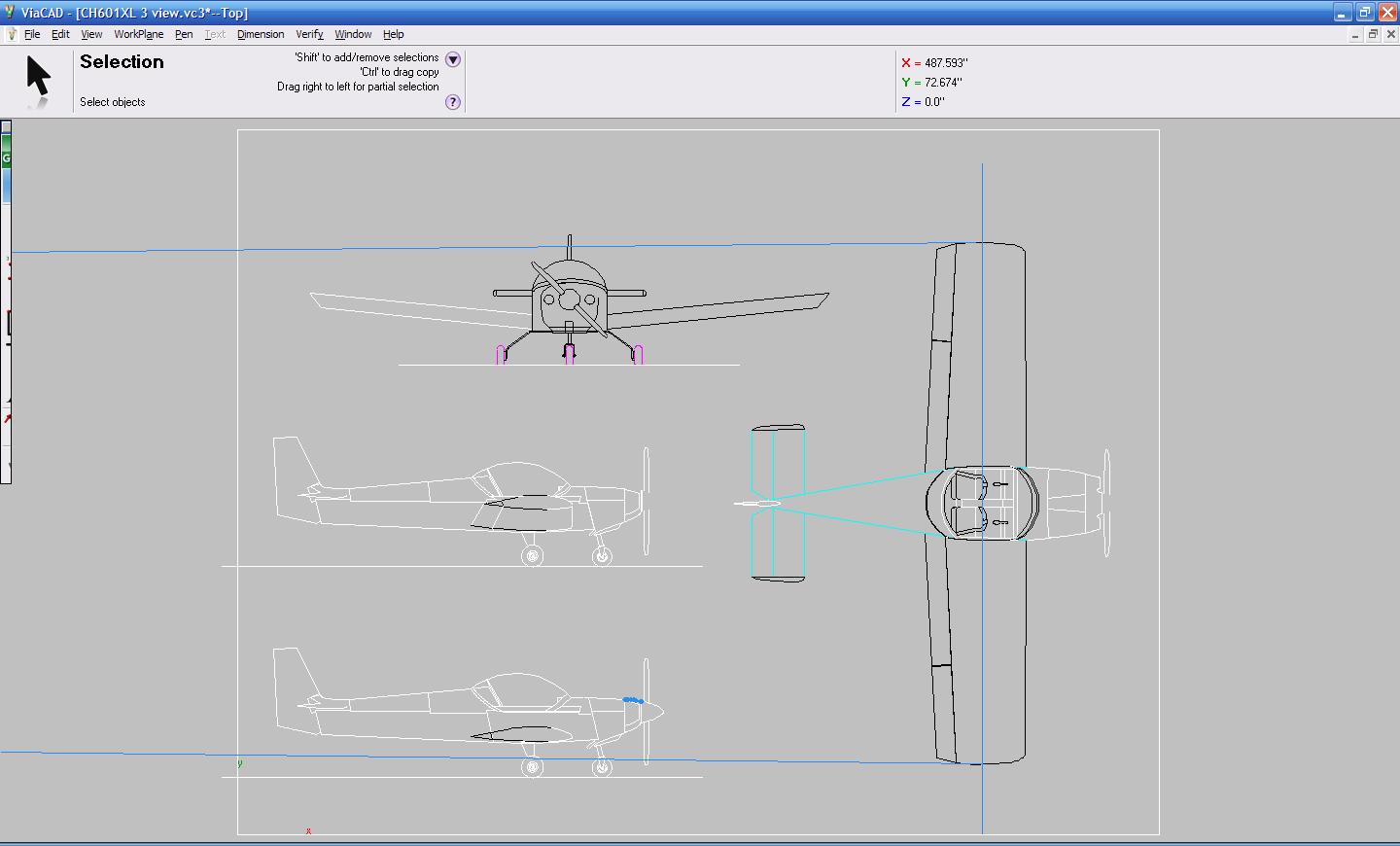

Gentlemen, I have just used a CAD system and drew up what you are trying to do. It works with lots of clearance if the lights are at the furthest point out and as high on the wing tip as you can get them. I also made mine perpendicular to earth so there will be good coverage above and below. I am using the AeroFlash units but the solution is still the same.
FYI
I have a snapshot here, the top view has two blue lines extending back 1200' to a vertex at the projected centerline of the aircraft. The lines don't touch the stabilizer or the wing tip itself so there is a clear view back.
The furthest point out is at the spar rivet line at the top of the wing skin per 6-W-9.
CAD layout of light rays
