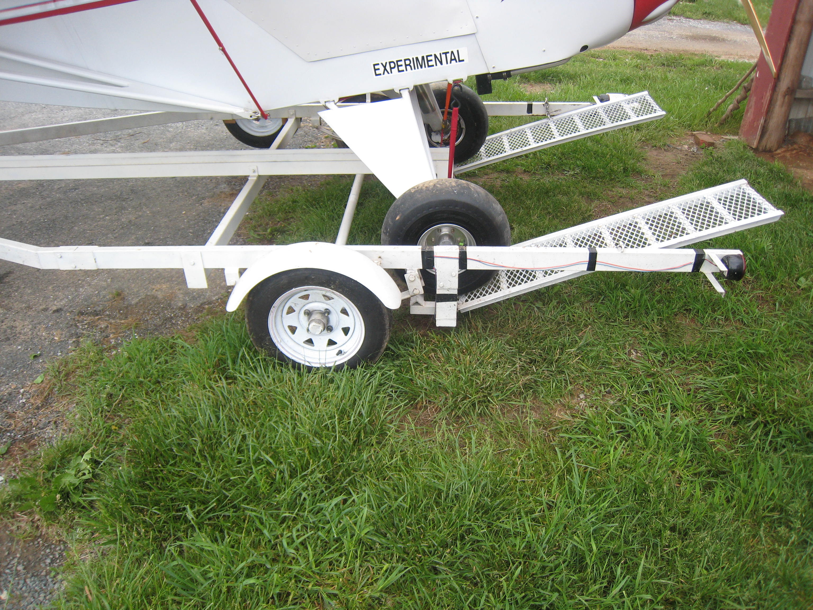

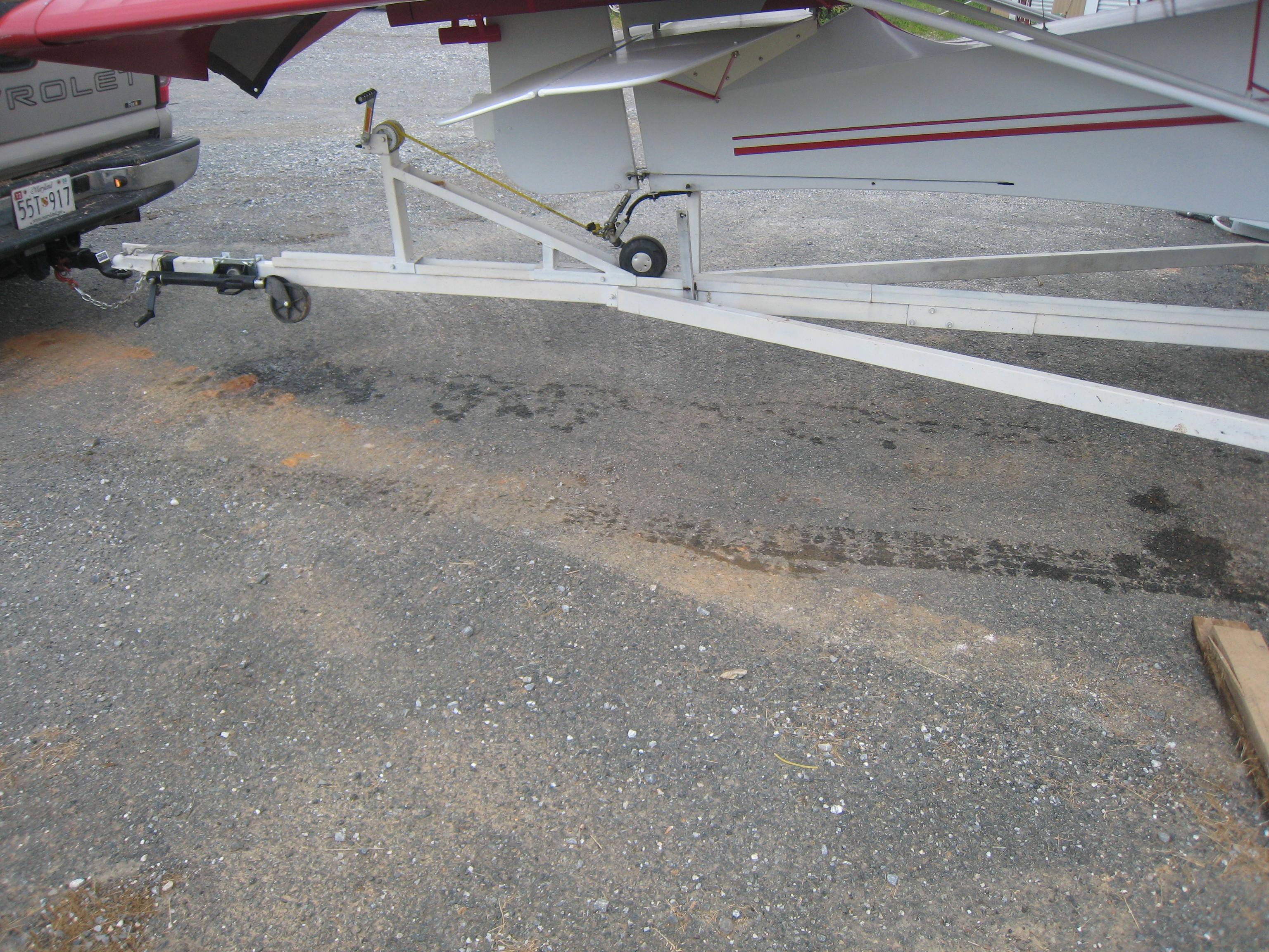

PostPosted: Thu Jul 03, 2008 9:10 am    Post subject: Hydraulic Lock Reply with quote
May I ask what kind of trailer you use Lynn? I have towed my Kitfox a few
miles using the towbar attachment but am reluctant to put too many miles on
the plane's tiny bearings. I plan to trailer it now on a 21ft car trailer,
with ramps and an electric winch to get it up to the platform. But I had the
trailer for other reasons, so I am wondering how other Kitfoxers "trailer"
their planes around.(?)
Bob Brennan
1991 UK Model 2 Kitfox
Rotax 582 with 3 blade prop
Wrightsville Pa

PostPosted: Sat Jul 05, 2008 2:33 pm    Post subject: Hydraulic Lock Reply with quote
(back from the trip) I used a boat trailer, modified for a wider
"stance" so that the planes' wheels will sit into a sort of "v", with
the back side of the v hinged to form a ramp for loading. I can send
you pictures if you'd like.

Hi Bob here is a pic of my trailer. This is a Skystar trailer the original builder put together. I'm currently working on a air ride suspension for the tail. It seems that the tail feels every jolt as I'm towing with 3/4 ton truck. If I was towing with a softer suspension like a car I don't think it will be that bad. I noticed your in Wrightsville I'm about a half hour south of Red Lion Just over the MD line. Your welcome to come down and get a closer look. What Field will you be flying from?
Nick W.
 Filesize:  1.17 MB
 Viewed:  663 Time(s)
 Filesize:  1.33 MB
 Viewed:  610 Time(s)
Nick Weiskopf
Norrisville, MD
kitfox !V-1200
Rotax 912ul
matronics(at)bob.brennan.
PostPosted: Tue Jul 08, 2008 5:52 am    Post subject: Hydraulic Lock Reply with quote
That is a very neat trailer Nick, perfect for towing a Kitfox any distance.
