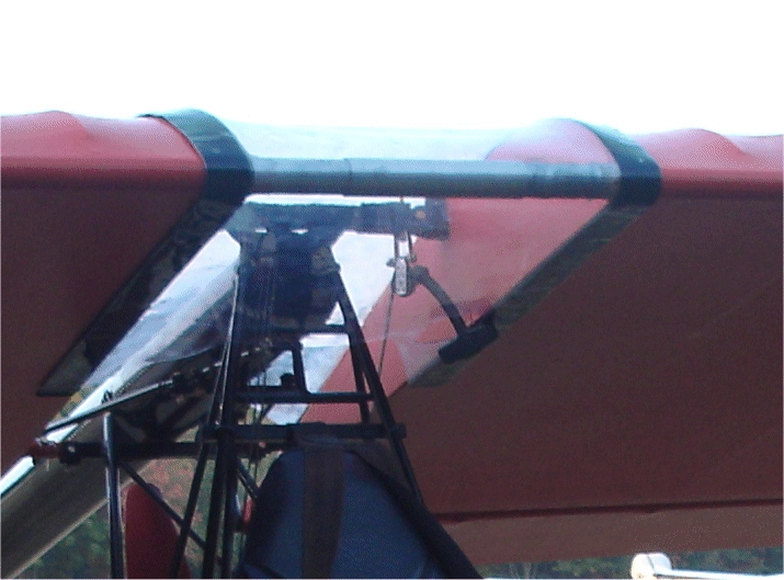

The diagonal bracing is a couple tubes that attach to the leading edge at
one end and are attached to the Main tube spare at the other forming a
triangle between the main spar tube, a rib and the diagonal brace.
They prevent the leading edge from moving towards the tip or root
directions from vibration, uneven skin covering tension spanwise, flight
loads and rough ground handling.
Yes, I understand that. I wasn't sure if that's what John was referring to
as "lateral bracing".
Your sleeve connecting the two leading edges might help that some if
clamped tight.
No, that provides no spanwise support. I imagine it was originally
installed to support the center gap seal, but it would also tend to prevent
relative vertical motion of the leading edges (i.e. wing twist).
-Dana

PostPosted: Mon Mar 24, 2008 2:17 pm    Post subject: Ultrastar questions Reply with quote
At 05:16 PM 3/24/2008, Eugene Zimmerman wrote:
On the other hand, if you ever develop even a slight bit of play in your
wing attach points you will
put "extreme stress" on those critical little diagonal braces inside your
wing.
Are you sure that is what you really want to do?
The sleeve isn't clamped tight; it's just a short piece of the next size
larger tubing slipped over the leading edge tubes. It stays on one side,
then when the wings are unfolded it slips to the center and spans across
both. There's no spanwise support other than friction, though I expect it
might help to prevent any relative vertical motion (wing twist).
Still, I have to think on this. There's always a "slight bit of play" in
any connection, and although I presume it was added to help support the
wing gap seal, I don't know that it's actually that important... and it IS
kind of a PITA to slip into place. OTOH, it WOULD add some additional
support in the event of a failure at some other point.
-Dana

PostPosted: Tue Mar 25, 2008 7:37 am    Post subject: Ultrastar questions Reply with quote
> If that sleeve was clamped tight it would translate all sorts of
vibration and flexing loads into those diagonal braces and accelerate the
loosening of rivets or crack them at the bends.
In retrospect I'd leave the sleeve unclamped.
Ray
Ray/Dana/Gang:
The braces on the nose of the inboard rib serve one purpose, to keep the
fabric from pulling the nose of the rib.
The leading edge braces are the important ones. I can not remember how many
the plans call for for the US and FS. This is a sensitive area for me and I
go overboard with 1/2" OD braces from leading edge to main spar on both ends
of the wing section.
There was never a requirement in the plans for a sleeve over the inboard
ends of the leading edge of the wings. Would never serve a structural
purpose.
Labhart Field, KY
Dana
Joined: 13 Dec 2007
Posts: 1047
Location: Connecticut, USA
PostPosted: Tue Mar 25, 2008 9:37 am    Post subject: Ultrastar questions Reply with quote
> If that sleeve was clamped tight it would translate all sorts of vibration and flexing loads into those diagonal braces and accelerate the loosening of rivets or crack them at the bends.
Well, as I said, it's not clamped; it's just another piece of tubing, about 8" long. Does take some pushing to get it over since there's a very slight misalignment between the leading edge tubes.
Of course, if there IS play in the other wing attach points then stressing it at the leading edge could either help or hurt... hurt, because it's stressed... or help, because the pretension might keep things from hammering back and forth.
The braces on the nose of the inboard rib serve one purpose, to keep the fabric from pulling the nose of the rib.
The leading edge braces are the important ones. I can not remember how many the plans call for for the US and FS. This is a sensitive area for me and I go overboard with 1/2" OD braces from leading edge to main spar on both ends of the wing section.
The US plans only show one 5/16" brace, on the inboard end (not counting the three braces that support the inboard rib). Thinking about it (and in light of why you consider it a "sensitive area", John) it _does_ seem kinda flimsy.
There was never a requirement in the plans for a sleeve over the inboard ends of the leading edge of the wings. Would never serve a structural purpose.
No, as I said I suspect it was added because a previous owner thought it would better support the gap seal. I'm thinking, however, that adding bolts or pins through slots in the sleeve (so there's NO load on the sleeve until/unless the leading edge moves, say, 1/2", which could _only_ happen if the diagonal brace failed) could be an additional safety factor.
-Dana
