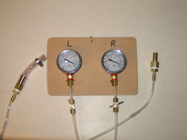

p.s.
you will need aset of vacumm gages. easy and cheap to make.
I think there is a picture here on the forum.

PostPosted: Sat May 05, 2007 8:05 am    Post subject: Re: Rotax 912 Idle Speed Setting Reply with quote
Hi Hugh,
Carb sync tool picture

I have given up with that tool you show in the picture and bought a
Carbtune 2-col and Toolpouch
http://www.carbtune.com/carbdtls.html.
Much superior.
As a matter of fact I have a brand new tool from Lockwood that I want to
sell Wink
If you are interested contact me.
-- Silvano
Roger Lee wrote:
Hi Hugh,
Roger Lee
Tucson, Az.
http://forums.matronics.com/viewtopic.php?p=110993#110993
http://forums.matronics.com//files/carb_sync_1501_110.jpg
